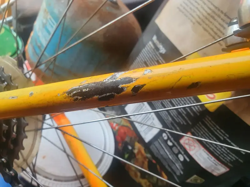

Hi there I'm after some advice from the wisdom of the crowd. I recently purchased a 1992 Marin Pine Mountain, it's a one owner from new, mechanically very sound. The fluro paint on the back stanchions has taken some major damage in the past. Is there anything I can do to spruce this up and protect the frame from further rust, or shall I just leave it? I've seen some awesome complete refurbs on here and might get to that in the future but for now I just want to ride this thing. So any ideas, pictures of bike and damaged stanchion included. 👍

If you want to protect the exposed raw frame, lightly sand it to remove surface rust and apply boiled linseed for rust protection. That's if you want to keep the patina but prevent rust. Other than that you can sand it down to bare and paint it with automotive touch up paints.

Bilt-Hamber Hydrate-80 would probably do the job. Chemically converts existing rust and dries to form a film for more protection.
Steel some nail varnish from the Mrs? Or use some of your own ;)
