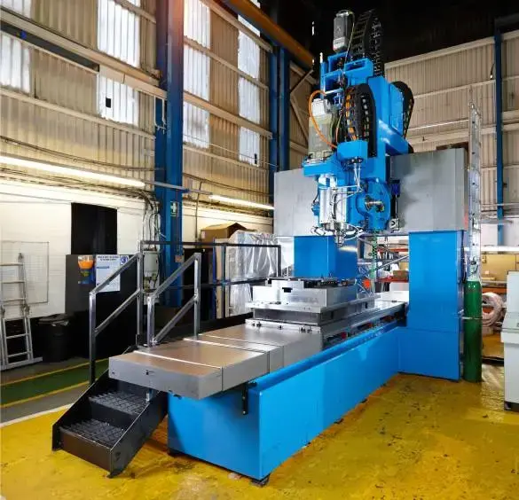

Kluber grease is fit once for the life of the component. I used it in my industrial research friction welding spindle bearings 100kn loading. Once you have done the bedding in runs, it was superb in use. I used to have to adjust the spindle bearings every couple of months to 50 micron play, cold. After the Kluber grease, ran for a year until the project ended without needing adjustment. 2009 price was £1000 per kg and bearing adjustment process took three days. Similar machine here. 50.jpg
Kluber grease is fit once for the life of the component. I used it in my industrial research friction welding spindle bearings 100kn loading. Once you have done the bedding in runs, it was superb in use. I used to have to adjust the spindle bearings every couple of months to 50 micron play, cold. After the Kluber grease, ran for a year until the project ended without needing adjustment. 2009 price was £1000 per kg and bearing adjustment process took three days. Similar machine here.View attachment 813057
You’ve got a big garage there for your mini mill………..😅
It was based in the Materials Science Lab at Manchester Uni.
