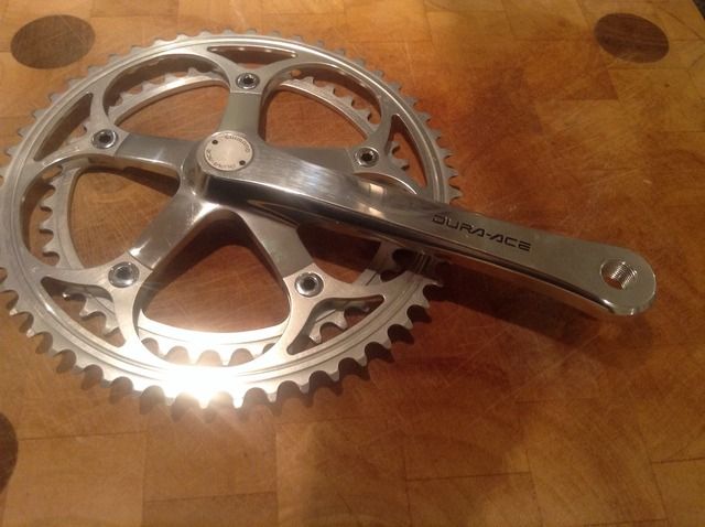

So Chainset landed- on first inspection it looked a bit worse for wear but using the magic of Solvol polish, now looking good..

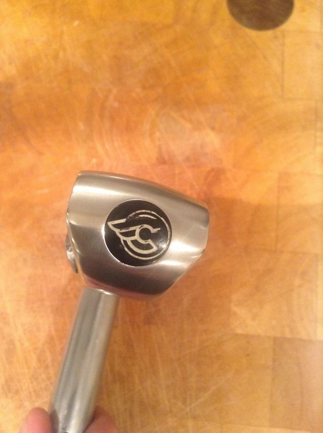

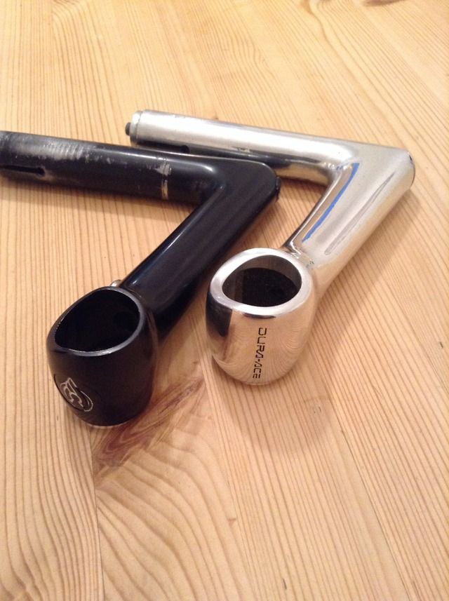

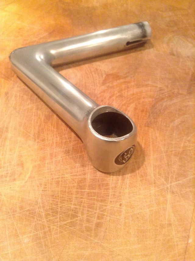

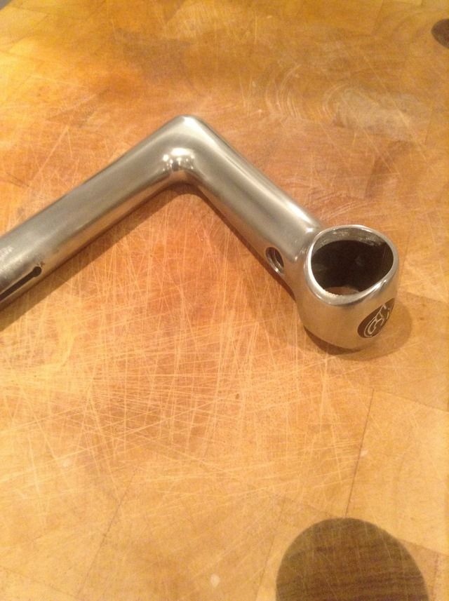

Other item to sort was the Cinelli stem. After trying Nitromors, I did try the Oven cleaner route.... it didn't touch it either! So only way was to break out the sandpaper. Being careful not to rub off the Cinelli stamp on top (luckily the front badge pops out so that wouldn't be damaged), I rubbed down with 600/1200/2500 grit paper in that order (last two used wet) - a polish and hey presto!
Before...
After...
I might break the Airfix paint out to repaint the Cinelli motif to clean that up, but I was rather pleased with the results.
