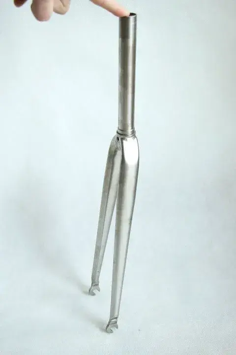

These are custom built titanium forks built by Wittson, I believe they weigh around 450 grams - that would be a 200 gram weight reduction.

Does Wittson offer the ti fork threaded? It's nasty stuff to cut a thread on, and fork thread cutters are expensive, so they might not.

The main issue with Ti forks seemed to be that they tended to be rather flexible. You can of course stiffen them up by adding more material (and weight).
