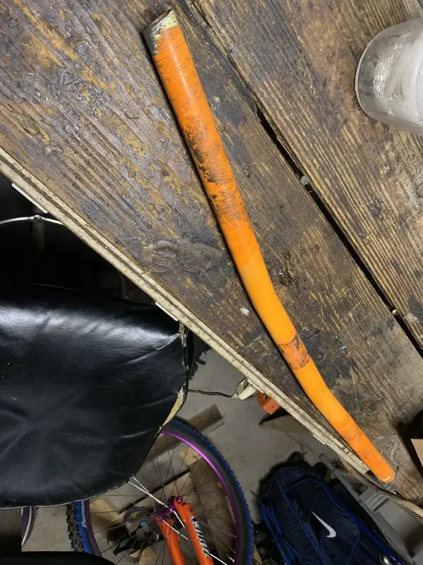

I had crazy lite bars that where orange(the color not the frame)22.2mm and had to be shimmed to fit the Ringle stem
(As soon as I get them weighed, I plan on posting to the ‘what is this brand part’ thread

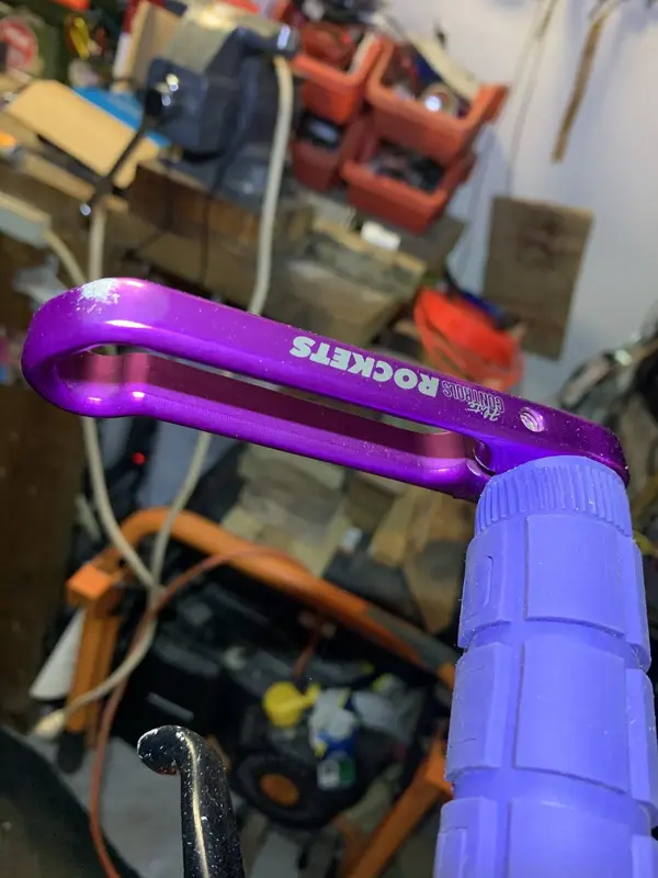

And some Control Flight Rockets bar ends instead of everyone’s 6inch curved pipe ones
