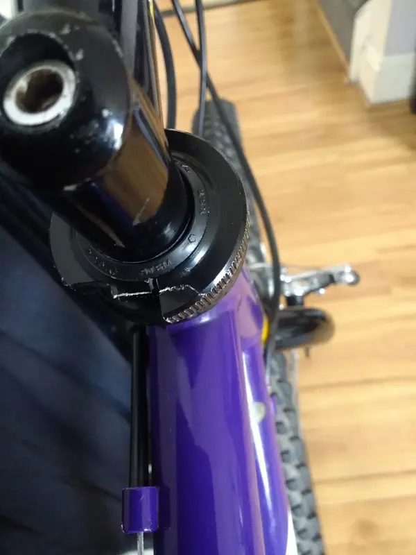

Hi folks, looking for some advice. Bought a 92 Lava Dome from eBay and have just got round to stripping and giving it some TLC. Noticed the ring where you set the headset preload had been mangled by over-tightening by the previous owner when I bought it (bit broken off that holds the allen bolt - looks like they'd also taken a spanner to it as the outside notches were stripped!!!) but it was still just about holding on. I stripped and rebuilt the headset today but it's now given up the ghost - the bit with the threads is cracking and I can't get enough tension to keep everything from loosening up (see pic).
Just wondering what my options are here. The headset itself is in pretty good nick apart from the aforementioned damage. The races are clean and unworn, bearings were in great shape so I don't want to bin the whole thing.
Also aware if I was to go down the route of replacing I'd be looking for something with a very short stack height (I need to measure properly but I know it's around 32mm). Has anyone got any recommendations? I was just going to stick a jubilee clip on it for now so I can actually ride it but looking for a more elegant solution long term 😊

I recall other aftermarket lock rings. Maybe look out for something. Gorilla I think made some, I'm sure there were others.
Thanks guys for the responses so far! Makes sense that there are aftermarket solutions out there, I've seen a few Impact headsets with messed up lockrings :) the Gorilla ones look absolutely indestructible! I might have to invest in one eventually, I like period-correct parts.
For now I think Mikey's solution will have to do until I've moved house and start to save up the pennies again.
