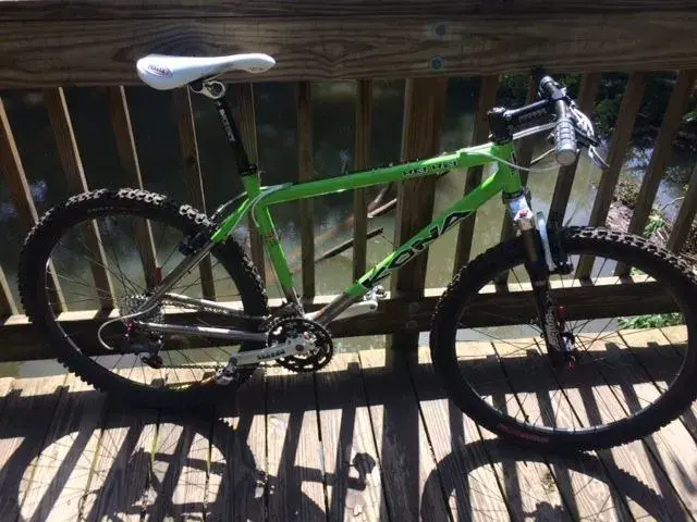

Finally finished the Hei Hei. Almost embarrassed at how long this took. Huge thanks to Stu in Toronto for selling me the fork a few months back. After new seals and a thorough cleaning, it was perfect. Took it for its first shake down ride last weekend. 11 miles on some slightly technical single track. It was flawless.
Build kit as follows:
Frame: 1998 Kona Hei Hei Titanium, 18", green front/brushed ti rear (serial# KH 18047)
Fork: 1998 Marzocchi Z2 Bam, 1 1/8”, threadless, Enduro seals, black sliders
Headset: Chris King Nothreadset, 1 1/8”, black
Stem: Race Face System, 120mm, 25.4, 5d rise, 1 1/8”, black
Handlebar: Easton CT2 carbon bar, no rise, 25.4, 580mm
Grips: Oury Lock Jaws, black with silver clamps
Brake Levers: Shimano XTR ST m950
Shifters: Shimano XTR ST m950, 3x8 speed
Brakes: Shimano XTR BR m950, v-brake
Brake Pads: Avid ceramic
Brake Cables: Jagwire Teflon-coated stainless steel
Front Derailleur: Shimano XTR FD m952, 31.8, TP, TS
Rear Derailleur: Shimano XTR RD m950, medium cage, red bullseye pulleys
Derailleur Cables: Jagwire Teflon-coated stainless steel
Cassette: SRAM PG850, 11-30t, 8 speed
Chain: Shimano HG-91, 8 speed
Cranks: Race Face Turbine LPs, square taper, 175mm, 94/58 BCD, white
Crank Bolts: Speed Metal self-extracting ti crank bolts – red
Chainrings: Race Face, 44, 34, 20t, 8 speed
Chainring Bolts: Black anodized
Bottom Bracket: Race Face Taperlock, 110mm, steel axle
Pedals: Shimano m747s
Hub Skewers: Salsa Flip-Offs, red anodized
Rims: Mavic 517s, SUP ceramic, 32h
Hubs: Chris King Classic, black, 32h
Nipples: DT
Spokes: DT
Tires: Panaracer Dart/Smoke Classic, 2.1” front and rear
Saddle: Selle Italia Flite Ti, white, 2001
Seatpost: Race Face XY, 27.0x350mm
Seatpost Binder: Salsa Lip-Lock, black, 32.0
I've said it elsewhere but I'll say it again - bloody lovely :cool:
Too true Frank. But on my PC it'll only allow a 'medium' sized pic. If I go with the large option, there are too many pixels. Maybe I can figure something out on my mac?
