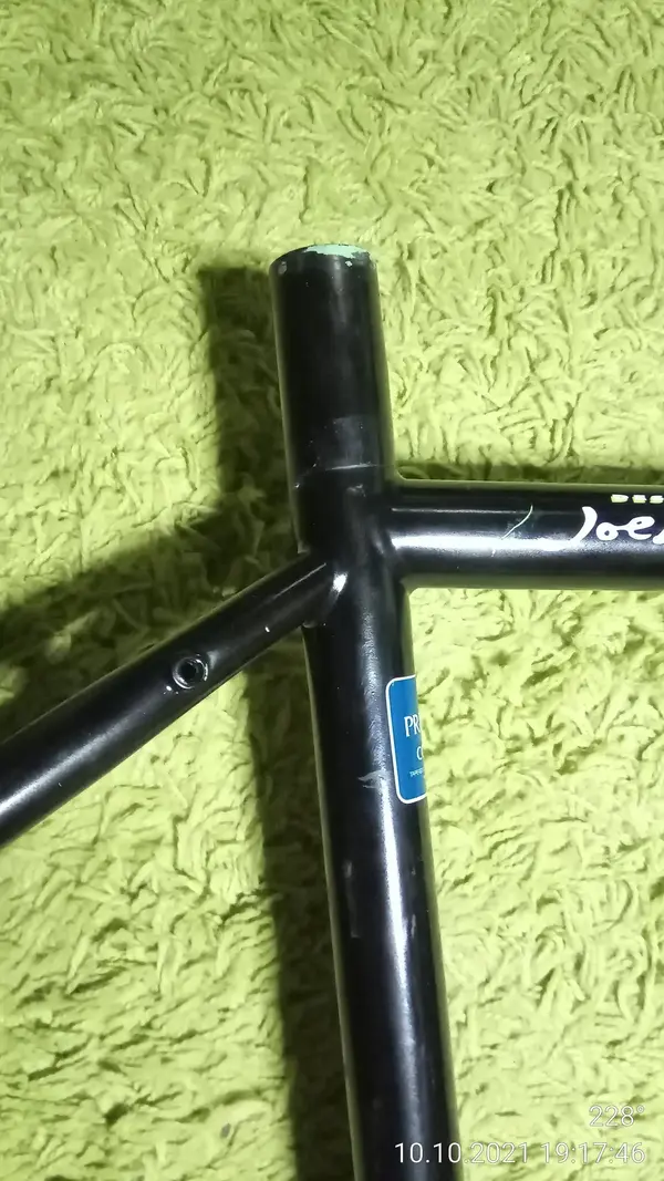

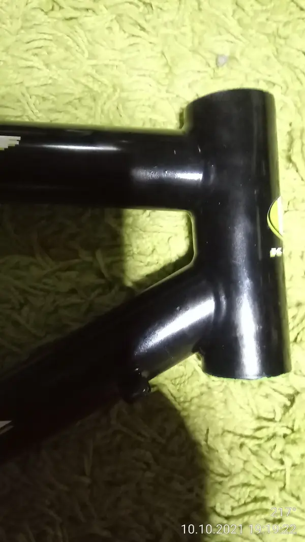

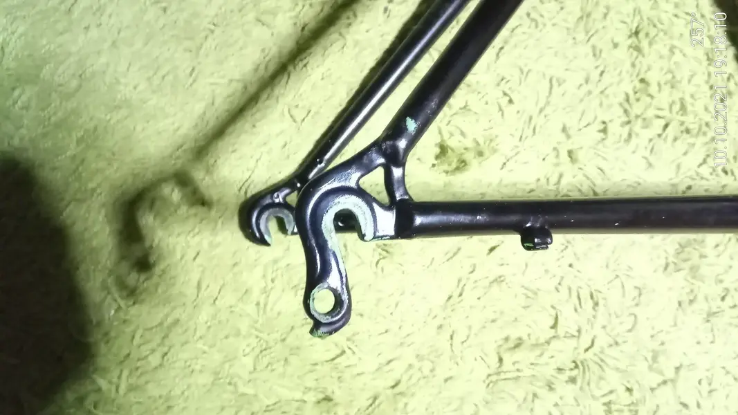

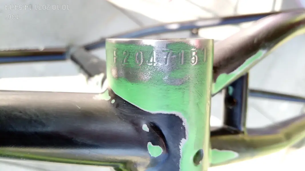

Hi first, I have registered for the Retro Bike Forum because I have a problem with the 91'Explosif frame. How easy it is to read I come from Germany / Bavaria. Here in Germany I recently bought a black Kona frame with beautiful 91'Explosif decals, probably the stickers are from Gil. On closer inspection, I have doubts about the year of construction and the model.
Frame 18 "(46cm seat tube, 55cm top tube)
Lime green paint and painted black
The frame has no eyelets on the dropouts
Internal luggage rack eyelets on the seat tube
no welded seat clamp
According to the frame number, it could be a 92´ Kona, right?
Maybe you can help me?
Of course, I can be wrong and it's actually a Kona 91'Explosif, I would be happy.
Greetings Bluelight

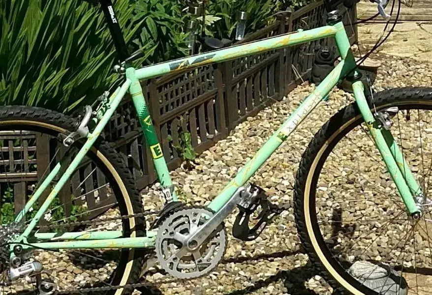

Hello and welcome to Retrobike.
With a Serial number of F204 7151, this would indicate that the frame was built at the Fairly Works in April 1992.
The bike therefore has to be a 1992 or 1993 model - it won't be "backdated" to 1991, which is a pity as Green was used for the German release of the "K" 1991 Explosif seen below.
The Integral Seat Post Clamp was last use on the 1991 Kona frames, and then there is the issue of the Dropout Rack Eyelets, which I guess could have been removed when it was painted Black.
I'll give it bit more thought, and meanwhile someone may come along with a suggestion.

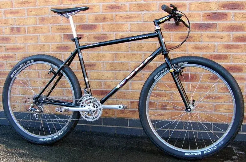

Pip.

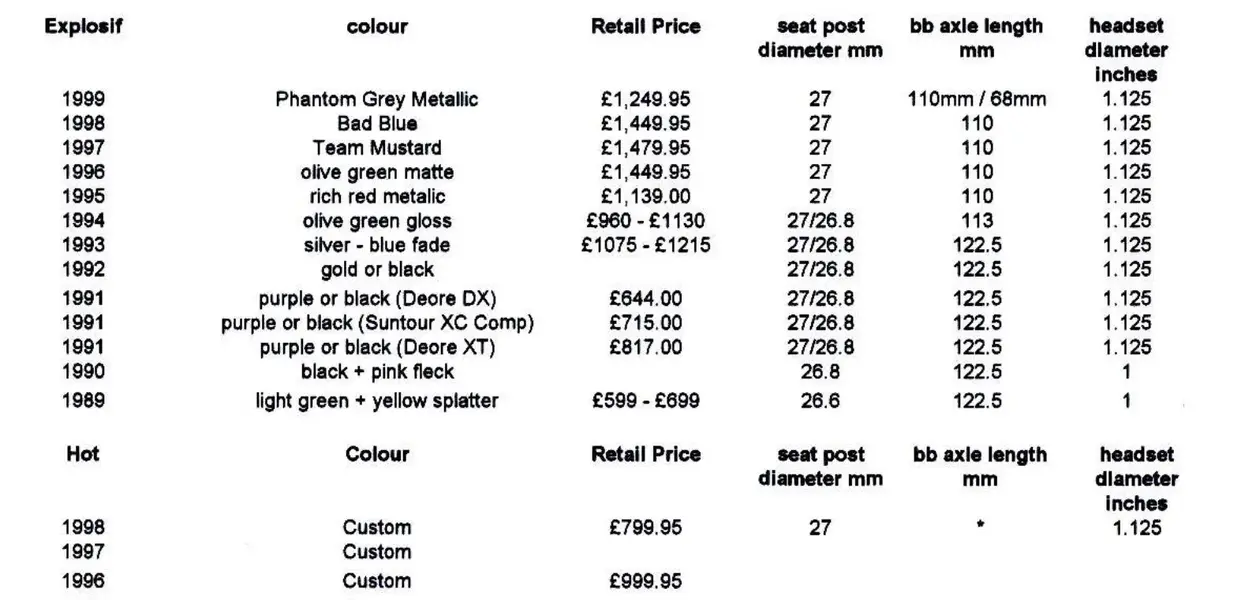

Hi again, I was hoping that someone with a '92 or '93 Explosif may add something here with the diameter of their Seat Post, as my documentation disagrees with what we have seen so far!
I have a Kona Spec sheet that says 27.0mm/26.8mm:
My former 1993 Kilauea that had the same Tange Prestige Concept tubing definitely used a 27.0mm Seat Post.

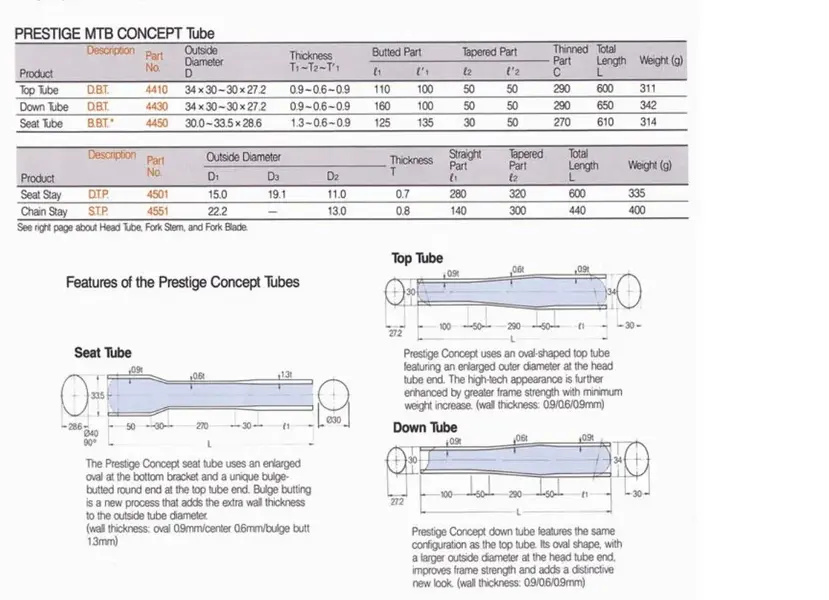

I also have the Tange Catalogue that specifies the Inside Diameter of the Prestige Concept Seat Tube, but it is making no sense to me; i.e. if you subtract 1.3mm wall thickness (twice) from 30mm - maybe there is a need to accommodate the interference fit or something?:
As for establishing the year (and model) of your frame, there are a few anomalies that are keeping me guessing - although as Tootyred highlighted, the weight is correct for a Prestige Concept Explosif.
Pip
Hey pip,
I think that with the seat tube cleared up for me!
I made a measurement error: - (((
The Explosif (?) Has a 27.0 seat tube!
I'm starting to think it's a 1993 Kilauea, or do you have another idea?
greetings Martin
Ah right okay Martin.
Mmm well a 1993 Kilauea would be a possibility. We have a 1992 production Serial number, so that means a 1992 or 1993 bike.
All the pictures that I have in file for the 1992 Explosif have a Seat Stay Rack Eyelet welded on top of the Seat Stay, rather than the Hank Bush that your frame has.

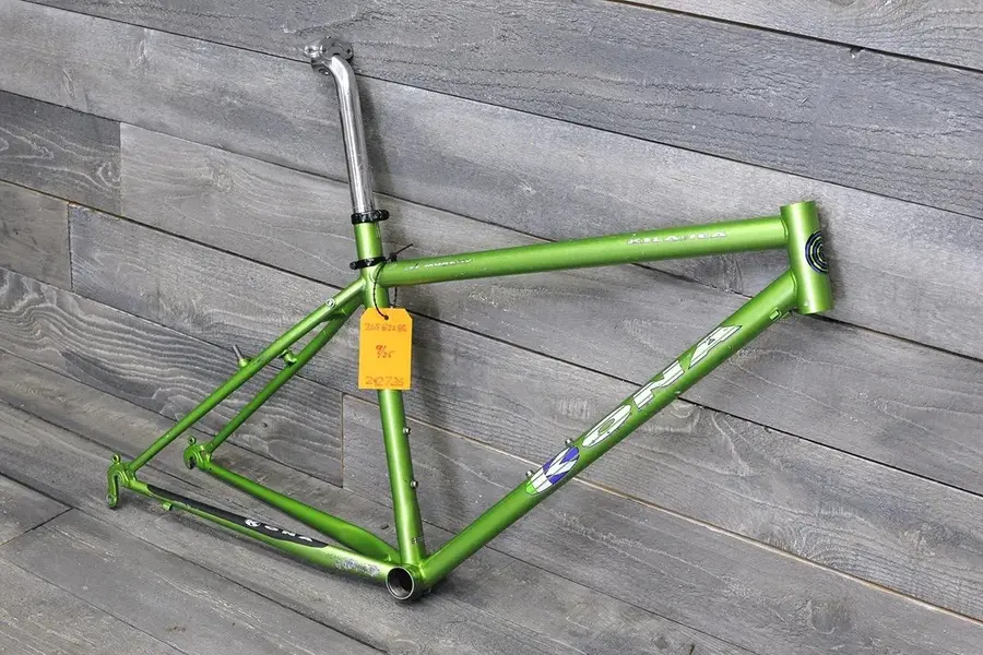

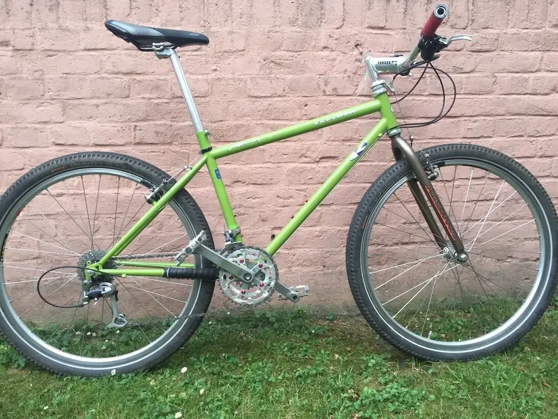

.....AND, check out this 1993 Kilauea in Green, which could account for the colour under your Black respray:
1993 Kilauea 17" Green:
Pip
