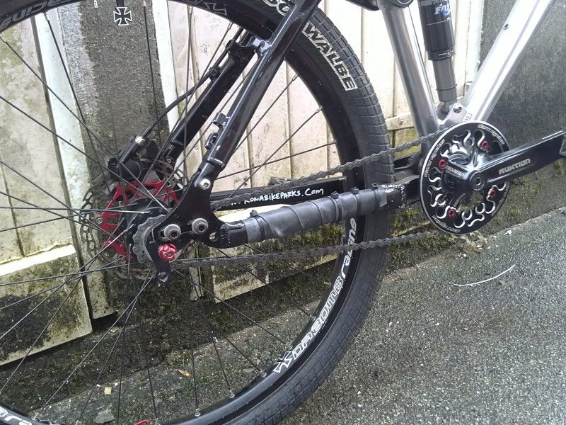

Kona Cowan DS (pg3).
its a cown d/s slope style frame.
yeah just use a cassette cog and the chain on there at the mo.
if you like it then go the whole hog with un ramped chain ring, ss chain and sprocket.

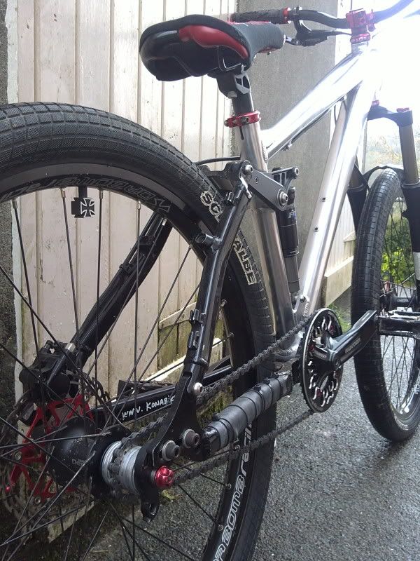

stripped the paint, the paintjob was poor
now onto polishing problems :LOL:
claimed weight is approx 33lb :) not bad going from a 38lb'er
(only differences to old bike are, forks, rotors (and then obviously different frame/shock))
paint stripped (the purple paint was effing poor), sanded with 1200 wet and dry and autosol'd. yet to get a finer grit(s) and go over it again as its currently shiny, but swirly
x lite bar plugs, x lite topcap
different seatclamp and stem
possibly putting my old dj3's back on soon due to lower stack height of stem
and singlespeed, had one go on it, felt weird and my thumb felt useless :LOL: but round the block and i seem to be used to it
running 16x36
