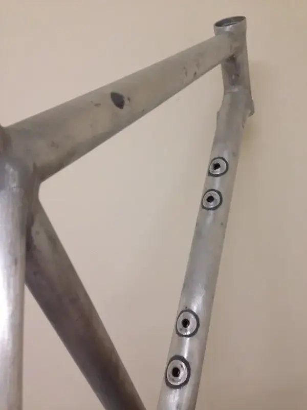

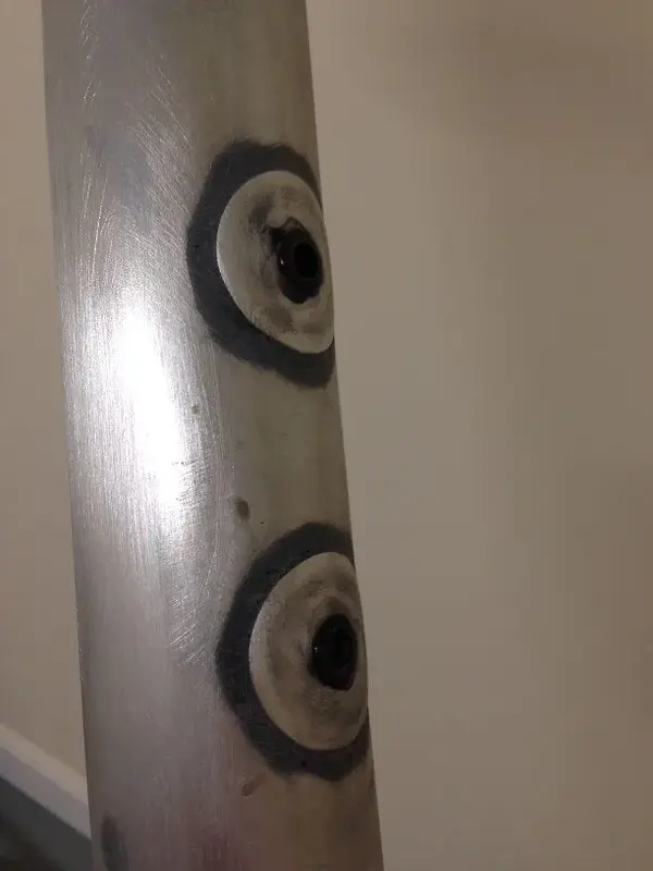

I got some 'GT PRO' Carbon re-enforced body filler from Ebay to smooth out the carbon and fill out the bottle boss rivets. Once I get primer on the frame I may need to smooth out the filler a bit more.

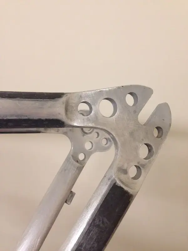

Got the carbon on the top and bottom of the seatstays :) Filled dents of which there were a few!

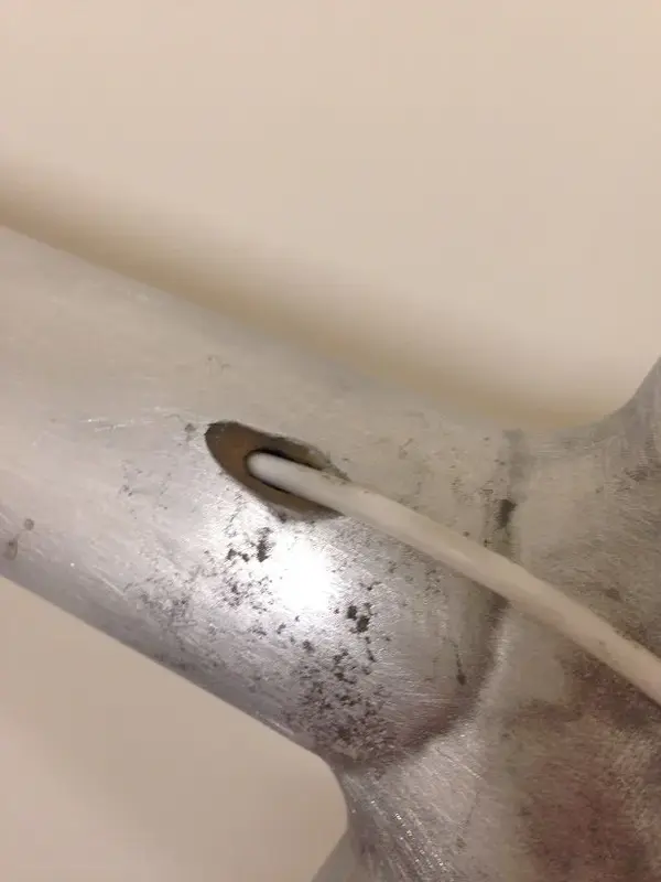

Repairing the drilled out cable exit was not easy. I have epoxied a small aluminium plate to the inside of the hole, re-drilled then filed the epoxy. I will have to check it is strong enough. I turned a new cable stop for the brake cable entrance and pressed it in to the drilled out entry hole.

The aluminium strip used to repair the brake cable exit hole was narrow enough to slide in to the drilled out hole. The strip was longer than the hole. I made a small hole in the centre of the aluminium strip and inserted a wood screw in the hole to use as a handle. Then cover the strip in epoxy, insert in hole, wait to dry then remove the temporary screw handle!

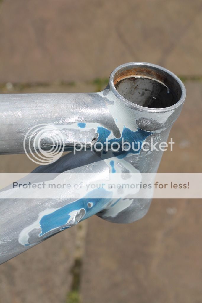

Another touch would be to use filler around all the intersections to make them as smooth as possible.
J
Good call with the filler on the joints and junctions. Was that originally applied by Klein on the Adroit? Some pictures I have seen of the early Adroits do appear smoother than the average attitude.
There are patches of pitting and corrosion around the cable exits and bottom bracket. I will try to smooth things out with a light application of filler before priming, then refine before a second priming coat.
Yes certainly the earlier ones.
J

Downtubes didn't have any carbon applied BTW.
Each layer of carbon was about 0.005" and there were 10 layers give or take.
