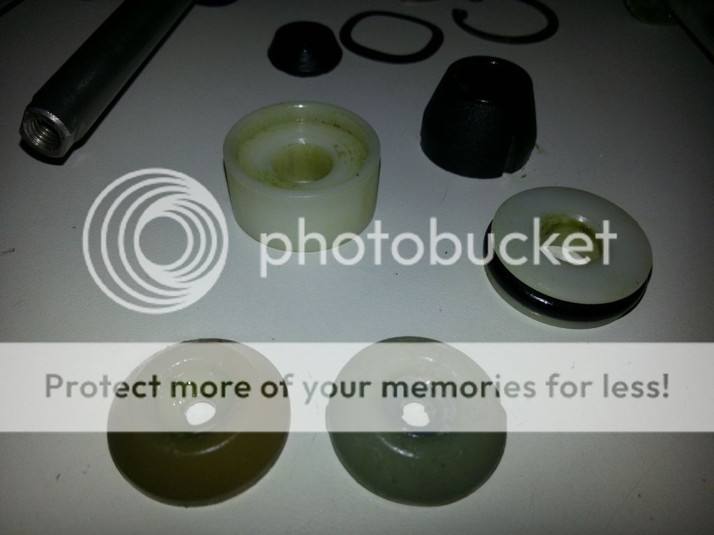

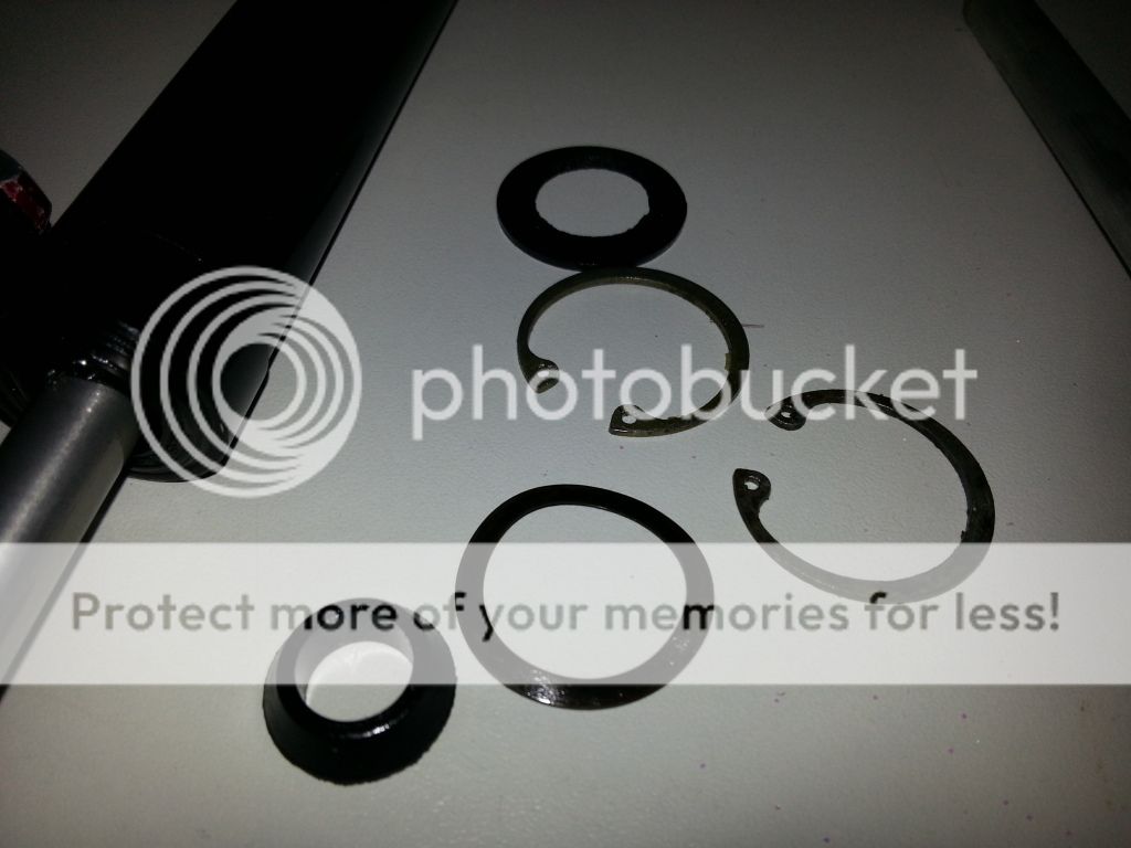

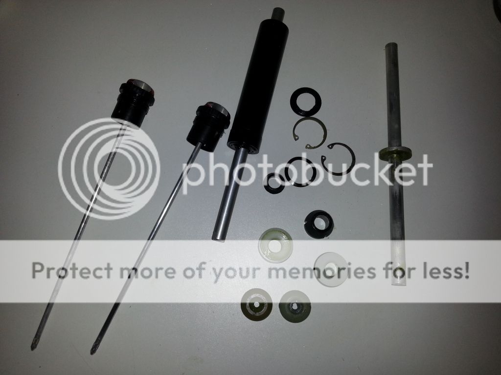

Right I've stripped it as far as I can. Apart from the damper.
Is only one of the top caps supposed to move?
What parts have I got that I need to keep?

I can see the first pictures now...
the very knackered leg is well gone. keep it for a rod to hammer and fit things with.
the other will be fine for a spare.
the bushing are shot though, don't damage your new legs with them. they should be a browny/grey colour. you can just see a bit on one of them.
can you take a picture of the end of your new legs
Which part do you want to see?
How do I change bushings and where can I get new ones?
