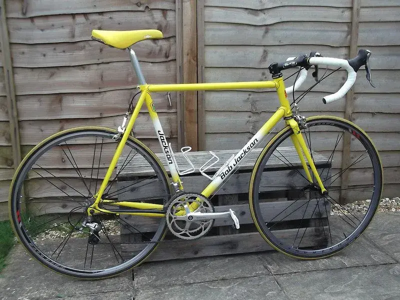

Welll the Raleigh and Peugoets broke at the same joint as Ed's.
The Lemond broke at the d/s dropout. Just after a paint job too! :facepalm: Had a new dropout put in and repainted it. Looked ace. Then a while later, I noticed a crack either side of the downtube, where it joins the headtube. Hadn't binned it, so I couldn't understand that. Didn't want to take a chance after that one, so I DID bin it! :LOL:
The Roberts had a d/s dropout go ( can you see a pattern here? ), , so went back to Roberts, who eventually put in a solid one to replace the very ornate original number. Had a respray. The same colourscheme as my Jackson, pictured below. Then it too, broke at the bb/seattube joint. Can't remember what I did with it then. Oh, and almost forgot, the Roberts was stacked at a race about a month after I finished building it :facepalm: :shock: :(
Was rebuilt from the seat tube forwards. Other than that, it was all original! :LOL: :LOL:
One of my current steelies, held out ok so far, after 3 years, shhhhhhhh! :LOL:
Mike
