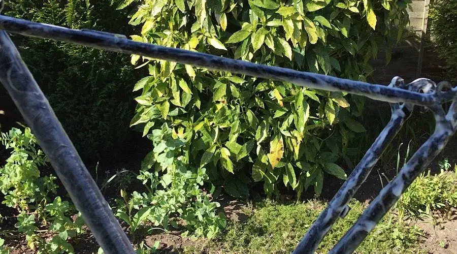

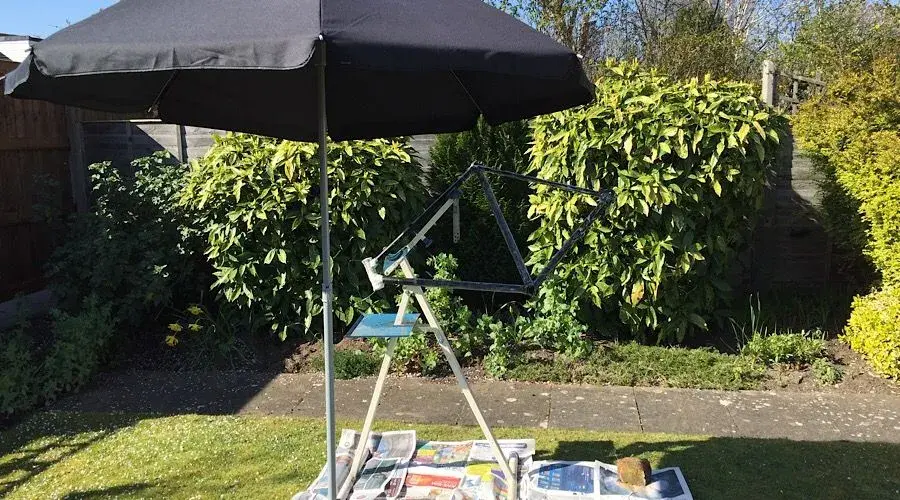

Blunder 2) 28/03/2019 Oh what a lovely bright sunny day it is today. :D Positioned frame in a sunny spot in the garden, It did say on the container to apply in a well ventilated area.....result..... stripper mostly vaporised. Quickly shaded frame with an umbrella and applied two more coats of stripper, left first coat 30mins then applied a second coat, left that another hour. My frame did not look anything like the one in allenh's photo, but at least I did manage to scrape a little paint off. Gave up today!...... going to try again tomorrow, you know the saying 'God loves a trier'.
In preparation for the third attempt tomorrow I have roughed up the remaining paint with a wire brush, maybe this will give the paint stripper something to soak into. I also intend to work in a more shaded area of the garden.
Below a few photos of my so far pathetic efforts.......no doubt more blunders in the thread to be continued. :facepalm:

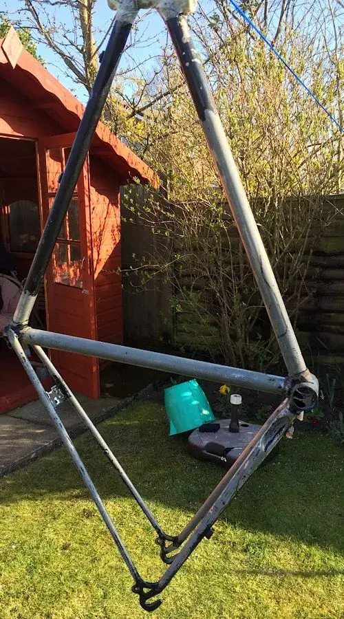

29/03/2019
Frame coming along a bit now, easier after roughing the paintwork with a wire brush then leaving the first coat of stripper for 1 hour before applying a second, leaving that for another hour before rinsing, then using the scraper and fibre cloths. It still needs another days work with the stripper to remove the rest of the paint. Then I start with the Stanley knife on the nooks and crannies. No real blunders today, maybe I'm getting the hang of it now.

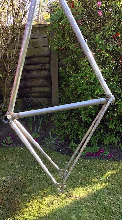

Day Three (Paint Stripping)
Repeated yesterdays action, and the frame is now stripped of its thick coating of black. I reckon it has been painted over its original coat as it was very thick, its also had a couple of coats of clear lacquer. Now just the nooks and crannies and some light steel wool work and a little rust treatment and then its ready for the primer. Waiting a couple of weeks to prime the frame as allenh's suggested, especially as next week the weather seems to be taking a bit of a turn for the worse. :roll:
