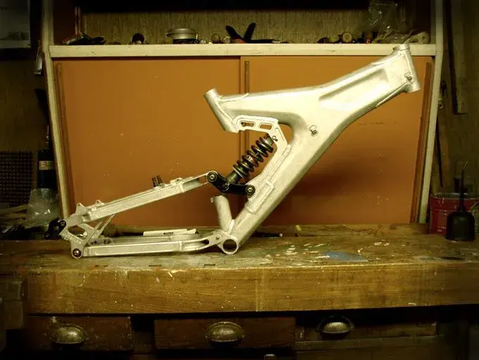

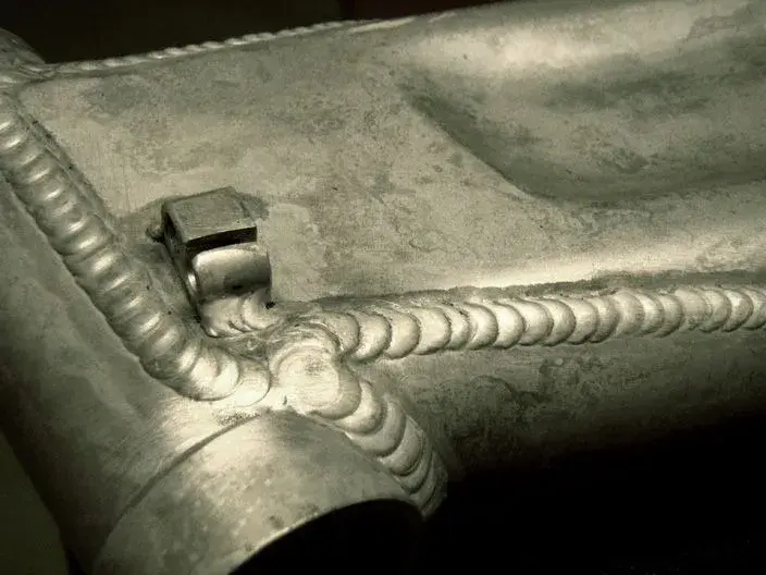

After experimenting with times (started with 30 seconds...) I found between 5-10 minutes gave the oven cleaner enough time to really start working. Then I took a cotton rag and scrubbed pretty hard. This didn't effect it so much, but I did notice a slight change, made the finish more matt if anything.
Did a few treatments - in the beginning there were a lot of white spots, which mostly disappeared after further coatings.
The end result is a matt, mottled and uneven finish, which in my experience looks very similar to the Intense Raw. And I love it! :D :cool:

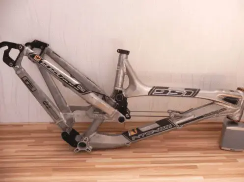

Thankfully that plan was derailed by deciding on the raw finish, and then I got further inspired by this 951 frame on ebay.de (still there I believe). So I changed the decal sheet that I'd designed for Gil The Almighty from a riot of colour to this subtle black and white set. They look super nice, can't wait to get them on the frame! :D

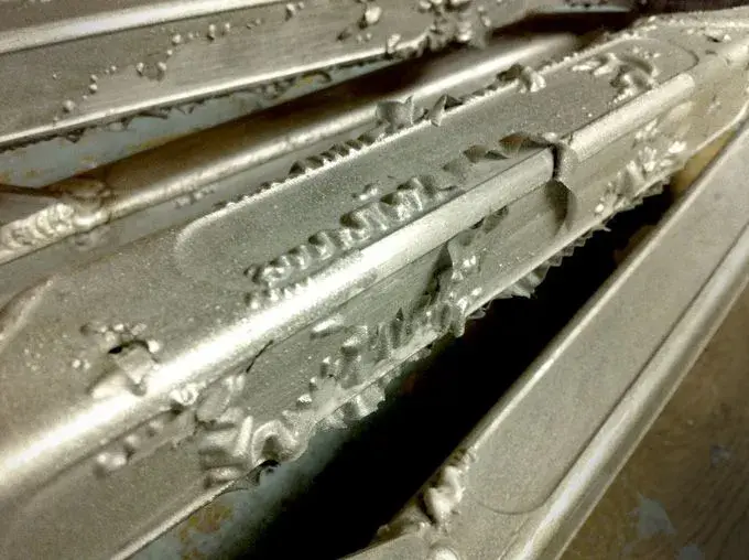

So, I'd got the stays stripped and treated, went to mount them and...... Noooooooo!! :evil:
The stays are from a later model, and I've now found out that the BB pivot on them has a larger bolt, making mounting the chainstay more or less impossible on this first generation frame. Next time I'll check this before starting a project :LOL: Luckily the original chainstay was crack free, but it needed a damn good clean up, which delayed things somewhat.
I also stripped the peeling paint from the rusty spring with views on a repaint. But found that the bare, part-rusty finish suited the raw frame so that's getting left unpainted to patina (ok, rust) naturally.
