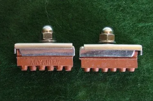

Hello. I have Weinmann type 500 caliper brakes that come with original pretty worn red pads. They look like these on attached photo (from the web, not mine). I found replacement pads for it, but I don't know how to safely remove old ones from their shoes and insert new ones.
I guess they should be pushed to one side and slided out, but there is some kind of one-way/locking perforation on the shoes which blocks them from being moved.

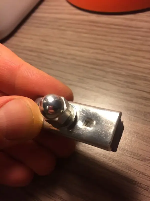

Thanks for the link to the post, I will check this out. Meanwhile, these are my shoes. Not sure if they're original, no marks on them. This perforated thingies is what I think holds pads in. It's kinda one-way hook-shape facing opposite open end of the shoe. I can move pads a bit just with my fingers, up until the point when they're rest up against those things.
Also, pads are longer version with 7 "dots"

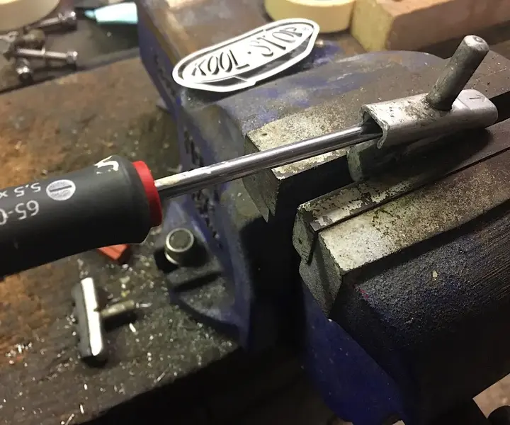

My ears were burning..... :D although mine didn’t have the catch, they stil didn’t want to be pushed out, so yes, a slim screw driver up the back soon has them out easily enough, then either a vice or a G-clamp will push them back in.

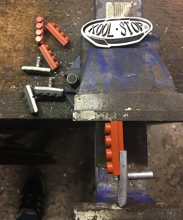

Quick guide to swapping them out if anyone out there is interested;
1. Hold the old pads in a vice and gently ease off the aluminium holder with a small screwdriver.

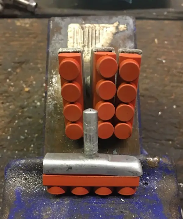

2. Next push the new pad into the holder, this might only go in a few mm.
3. Whilst supporting both the pad and holder between thumb & forefinger, slowly & carefully close up your vice.
4. Easy peasy! :cool:
