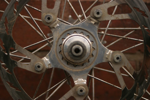

Anyway, a hunt round the shed yesterday revealed that I may have a spare 15 spline spider (no disc, disc bolts or lockring). You want to make me an offer?
I have a 5 arm spider sitting idle on my bike BUT I don't think it has that many splines. Did they make one with less? (looks like some sort of slot on arrangement like a cassette)
Will double check when I get home from work though.
No need to wait 'til you get home:
Six splines (this is from a Bulb, circa 1998, with 20mm thru-axle):
Five splines (I think this is from an earlier Bulb front hub, circa 1997, it's certainly not an XC) :
You can use a 15 spline spider on a 5 spline hub, but not the other way round.
The 15 spline pattern was the first spline pattern developed to replace the previous screw on design. Here it is on a '94 XC rear hub:
And here's the spider for it:
