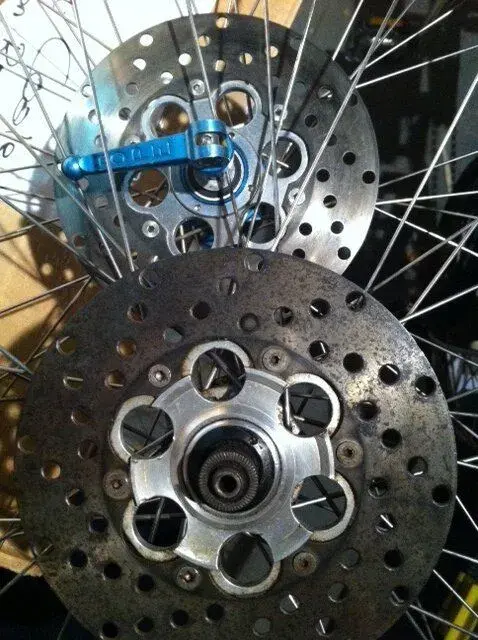

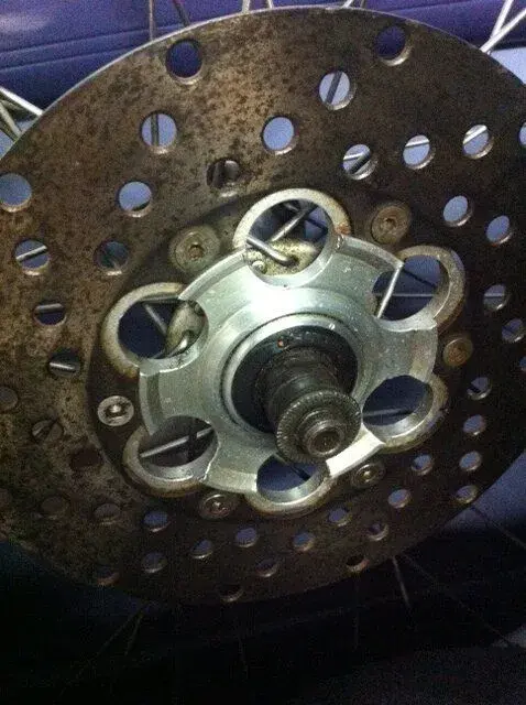

Close up of an early experiment - Shimano hub M732? with the non drive threaded for a hope disc carrier. this was Rod_saetens.
Best I can tell theres OC on one of the flanges which I believe makes it Mar 1990?
Seems a little old? Unless it was just the best one they had to hand?
Quick snap comparing the rear with my front attached to a hope suspension hub - although the spiders are superficially similar the later one is a flat plate whilst the older one has had far more machining.
Inner diameters of the spider are totally different too - 40 odd mm for newer - 33.4mm for older.
could be about right - I'm guessing it is a pre-production prototype, or an early tandem, although I could be wrong, when I spoke to one of the Wetherhills a few years back he said they tried lots of different things back then and no real record was made. The first hubs they actually made were a tandem design with huge flanges. I'll need to check but I'm sure I have both of those flange designs but for splined mounts. how thick is the disk on the old one?
