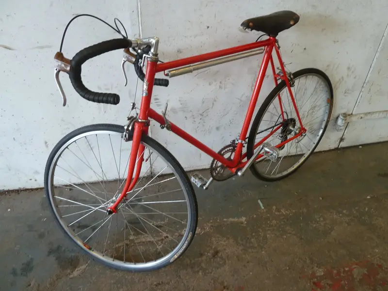

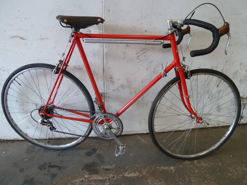

Holdsworth just finished
Rebikecumbria
Holdsworth that looks to have been repainted at some point just thought i would post for your delight
any comments or knowledge much appreciated

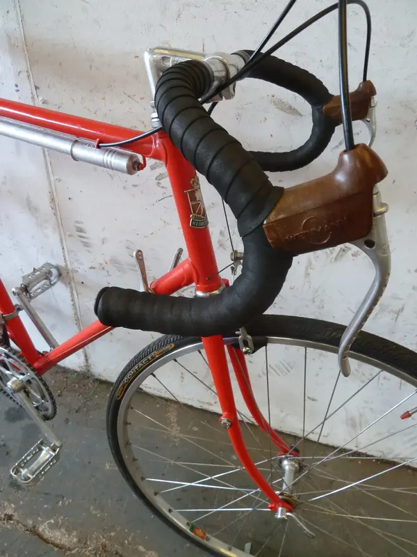

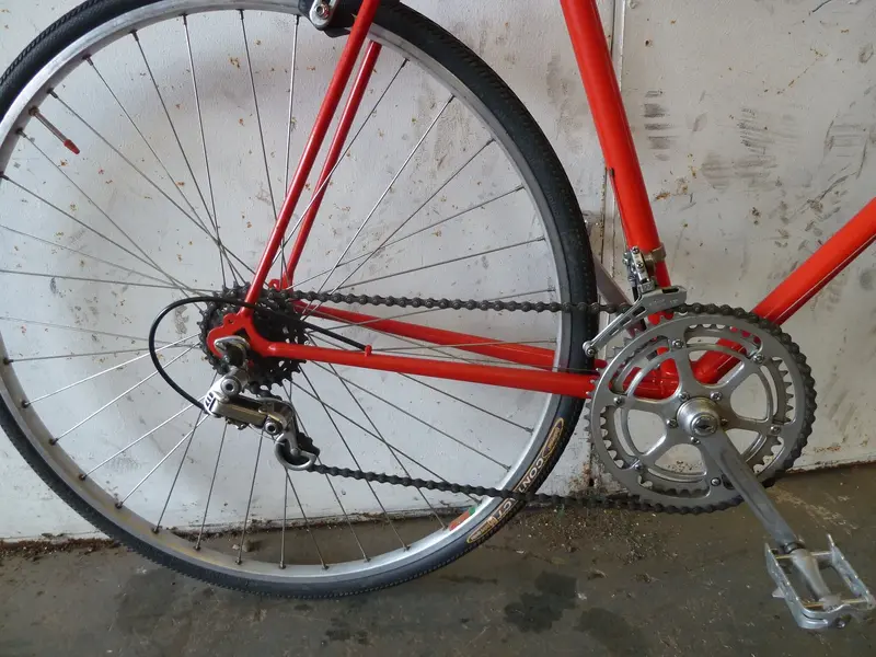

Nice bike, since you asked..
Saddle clip should be to the rear of the seat pin. Front q/r should be on the left not drive side. A fist full of seat post showing would look better. The stem is a little short for that frame size. Bar tape should be under the hoods. Brake cables may benefit from being behind the bars, making sure the rear cable is behind the front. Chain looks a little tight, check in top gear, big ring, small sprocket, jockey wheel centres should be at 90 degrees to the floor. Or chain wrap big on big plus two links. Small point line up the tyre name with the valves.
Apologies if that is not what you were expecting, I only have love for what you guys do. In fact the Raleigh Dune Dancer in my signature came from you.

cruel to be kind. :)
still a nice looking machine, although it does have the look of large bike smaller rider syndrome.

constructive criticism, pointers and knowledge are always welcome
