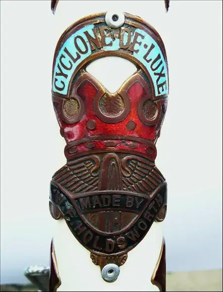

Pic of 1950 Cyclone Deluxe with lugs showing additional spearpoints, unique head badge and similar fork crown to your own (Kilgariff):
Pic of 1950 Cyclone (not Deluxe) from Classic lightweights (with later 50's badge) showing less elaborate lugs as yours (modified Nervex Pro) and again similar fork crown to yours:
Velobase Cyclone Deluxe Headbadge (used in years 1948 to 1951):
Brass headbadge off a 1948 LaQuelda (Velobase) and probably similar to yours from what I can see. I've also seen an aluminum 1951 similar design badge (CL Zephyr):
