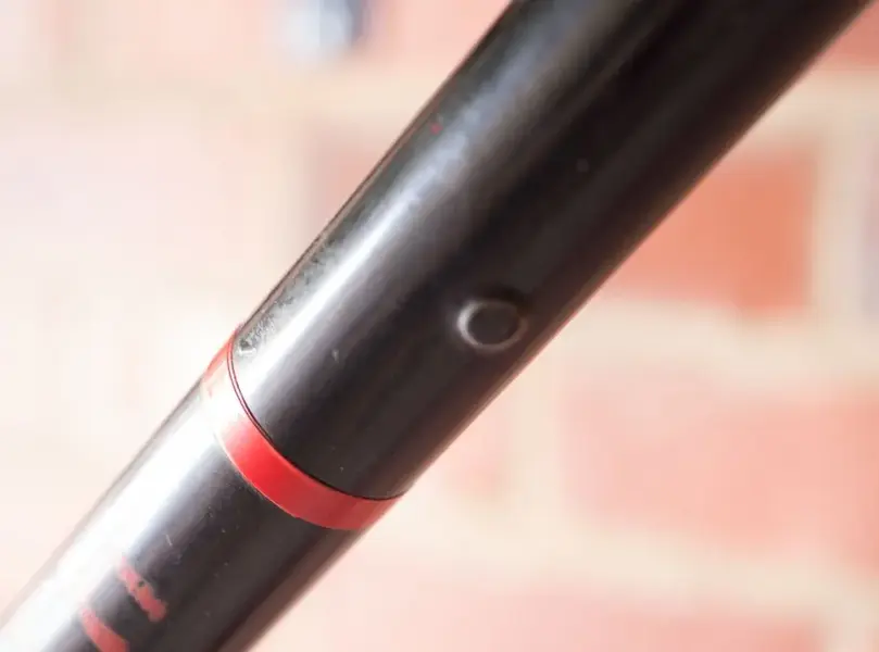

I have one more puzzle with it though - the next photo shows a small stub on right hand side of down tube fairly near the top. Is it something cut off?
yeah, from the pictures above I could see it just on the lower side of the downtube, so I also think it's to stop the shifter's band from slipping down.
