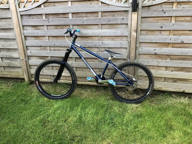

Help with identifying this Marzocchi fork pls?
Are these seals decent? I got a '99 Bam Z-something that leaks past the right-side seal, it's got those seals by the looks of it but installed by ways of a screwdriver judging by the tool marks on the dust wipers. I can tolerate this small leak for now but I'd like to fix it during winter while it's cold and dark and all-around miserable outside 😂
They seem ok so far, one of the original seals was leaking and these seem to have stopped that. I wouldn’t say that they’re oem quality but they went in ok and seem to be doing their job. 👍
Well, it’s inconclusive exactly what forks they are, but they do seem plush after a fresh dose of 7.5w oil and new seals..
They’re getting fresh decals next week hopefully, badged up as Bombers.. if only because I like the font and colours of the decals I’ve chosen...
