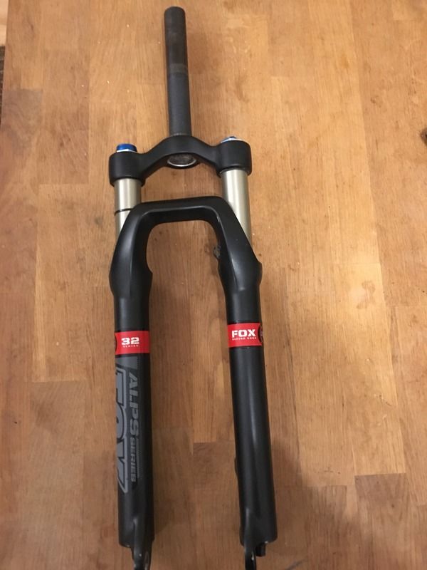

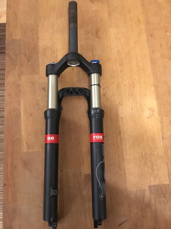

Issue 7. My ocd. With a fox shock at the rear it seems wrong not to have a fox fork. Should I forget this notion and use something from the stash (I've a couple of reba forks going spare at the moment), or source a fox fork? Annoyingly I sold a talas fork a week ago which would have been ideal. I do have a float 100 rlc with v mounts. Again the ocd is kicking in and saying as I'm running discs (or will be), get a disc only set of forks. I could just remove the v bosses and blank them. Damn that ocd.
