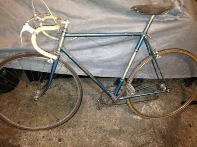

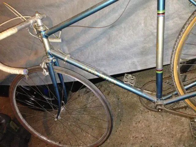

I've got an Avant Coureur (I think it is anyway - maybe you could confirm that Keith) lurking in Dad's garage and it's completely original I shall try and dig out some photos for you to have a butchers at. Or I'll photograph it on Wednesday if I can't find them.
Here you go......
Sellers photo's, so as usual they don't show the business end of things.

Actually now looking at the pics, I think its a 60's Avant Coureur by Holdsworth.
Too modern for you though.
Thanks for the pictures lovely bike :)
I hadn't heard about the over glossiness I will have a look into it. The only problem is that it is the closest to me, I live in the loughborough area and couldn't find any other places that do respray.
As soon as I saw the pics I thought of Holdsworthy. Not Holdsworth although there were some family relations. Holdsworthy were the import and trade wholesalers, also building quite good value frames for the trade who bought the names. I sold loads of the Freddie Grubb £7.12.6d frames, made with reynolds grade A drawn tubing.
