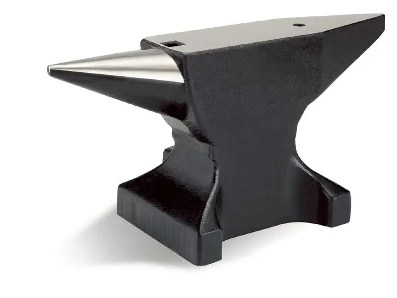

All the above advice is good to me but if all fails, buy one of these............
