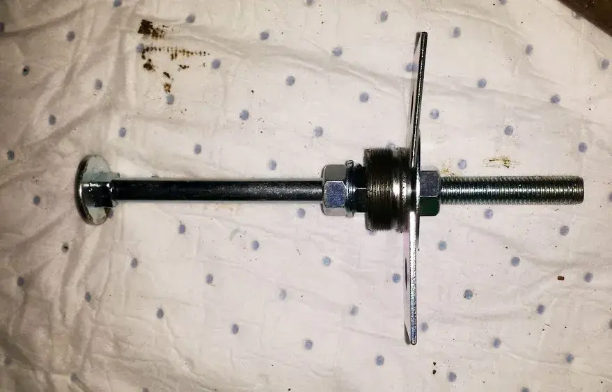

I'm there. BB fixed cup removed with a version of the Sheldon Brown method i.e. whatever I could find in the garage and £1 spent at the local hardware store. Thanks for all your help.
