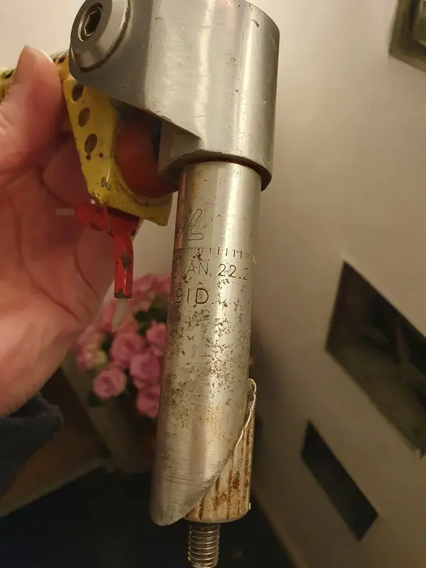

Wanted Girvin flexstem 1 inch and not too long
For a 1" headset it needs to be 22.2mm (standard)
A 25.4mm (1") is the size that fits in a 1 1/8" (OverSize) headset.

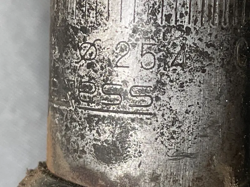

I am now confused. Below is a photo of the original headset, which I have checked with calipers and it measures 25.4mm. Therefore I would expect a 25.4 dia Flexstem to be a correct replacement? Welcome clarification IMG_5536.jpeg
If that's the stem then mine is an identical OD

A headset is the outside diameter of the steerer tube.
For threaded, the then stem goes on the inside of the steerer, so is smaller than the 'headset size' by 1/8"
For an Aheadset/Threadless, the stem goes on the outsize and is therefore the same measurement as the headset.
Hence a 25.4mm quill stem is for a 28.6 -- 1 1/8" headset.
Something many threaded era people* don't realise and advertise wrong (or right and the buyer doesn't realise)
*or people who have forgotten because they're now 30 years older and honestly didn't even think to think about it. Happens to all of us.

You have a 1 1/8" threaded headset, if you're ever looking for a new one.
