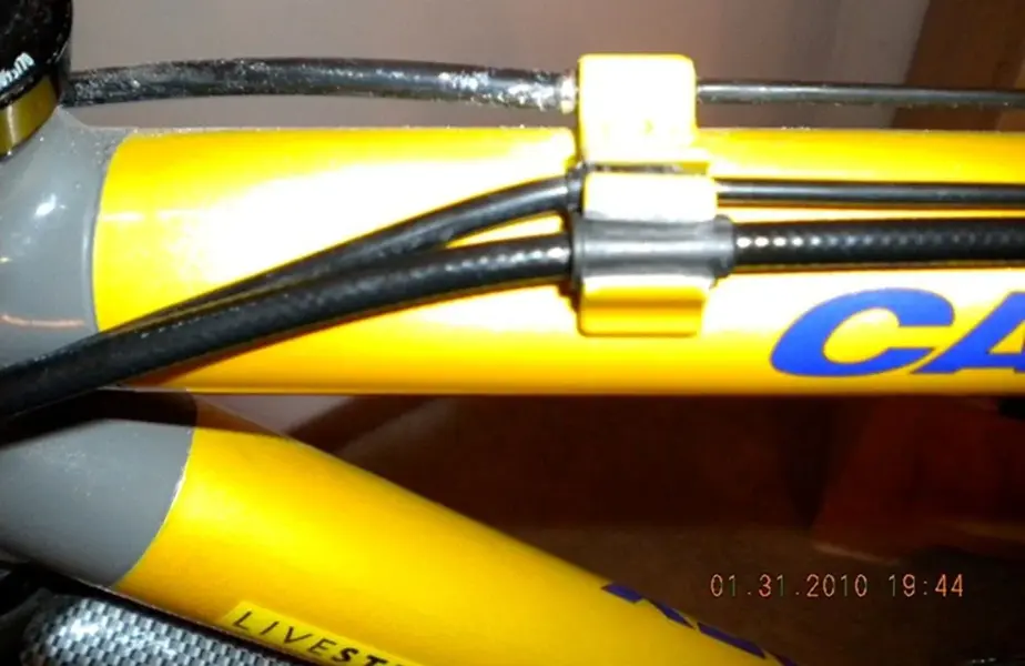

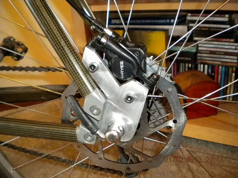

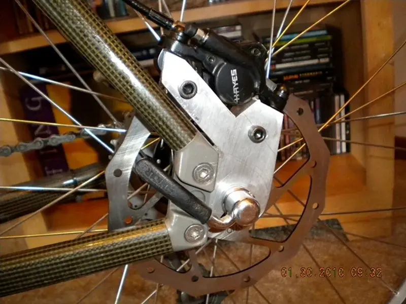

I Made a Rear Drop out out of 6061 Aluminum plate that allows for a Disc Calipper to be mounted to it, I will take Pictures to Show this, If you are interested in This? I Like the Photos of your rebuild!! I am just upgrading mine, from parts off my Specialized Epic, as I upgade that. plus the Disc Hubs. I am going to Remove the Rear Brake Bosses this Spring, Grind ever so carefully I suppose along with the rear Cable Hanger. I filed the cable guides on the top tube to fit the rear Hydraulic line through with the plastic Specialized hose shims to lock them in, looks clean. Where did you get the Giant Decals? and the Cadex decal? it does look Sweet!!!
