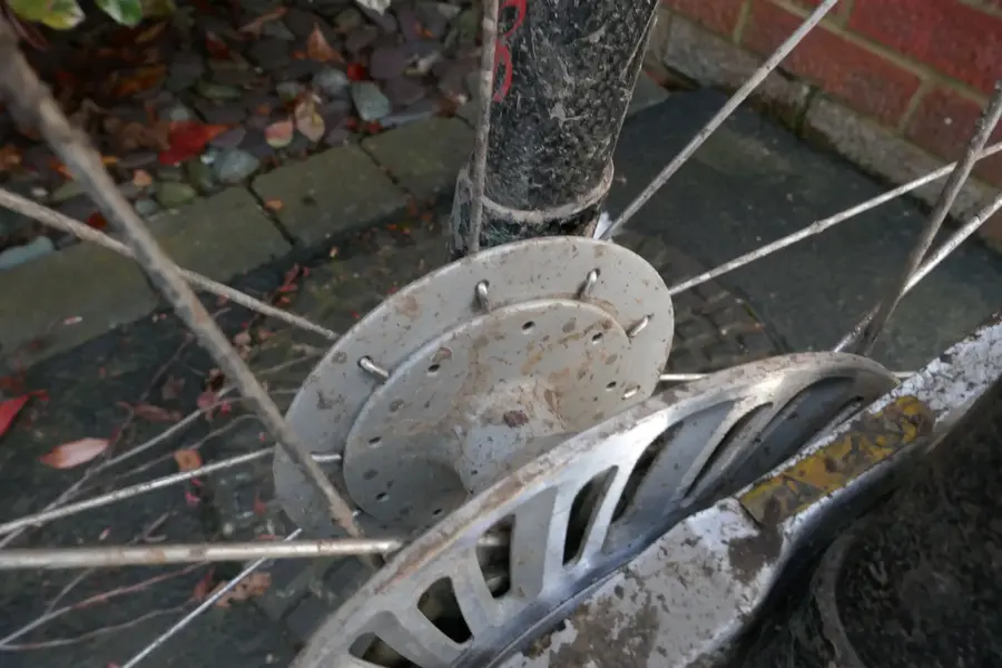

Here are two photos showing the 700C front wheel of a Cleland Landseer showing the Qwikspokes at the hub.
Note that the front wheel had been built using a 1 cross pattern on the roller-brake side and radial spokes on the other side. In all 20 spokes have been used. Given the 700C/622mm rim and intended heavy off-road use this is relatively a low number of spokes. The fact that the wheel is still true and no spokes have broken after several years of use is testament to the inherent strength of this method.

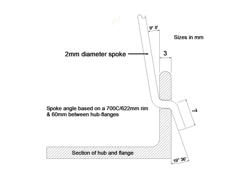

Here are the spoke dimensions as used on the wheels in the above photos. The same spokes have been used to fit both the inside and outside of the flanges.
The drawing shows a spoke as fitted on the inside of the of the drum brake side of the wheel. To make sure that the same spoke would also fit on the outside of the flange, the end of each spoke has been angled about ten degrees away from the main spoke axis. Because of this, the spokes positioned on the outside of the hub (as shown in the photos) seat more neatly with their ends closer to the flange.
Note that these spokes would not seat as well if they were built into a narrower flange. Also, the spoke angle given will change with different rim diameters and hub-flange spacing.
Hi Graham. Thanks for the excellent photos and the detailed drawing. I think you’ve answered several design questions around this.
I found a couple of videos like this, Calculating bend and setback allowance, that also help to explain how the overall length of the spoke can be calculated.
