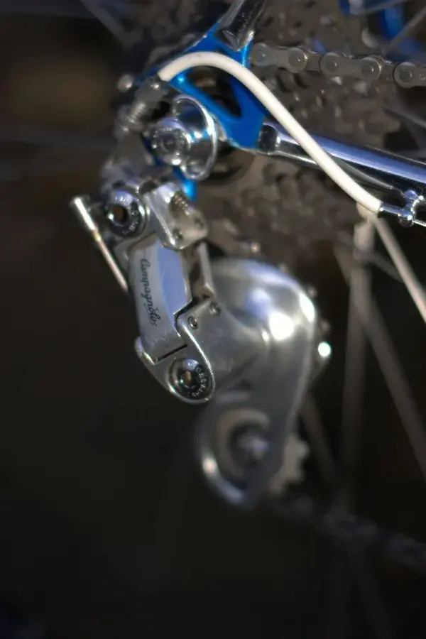

Re: Gavr goes Italian - Tommasini Super Prestige 1990

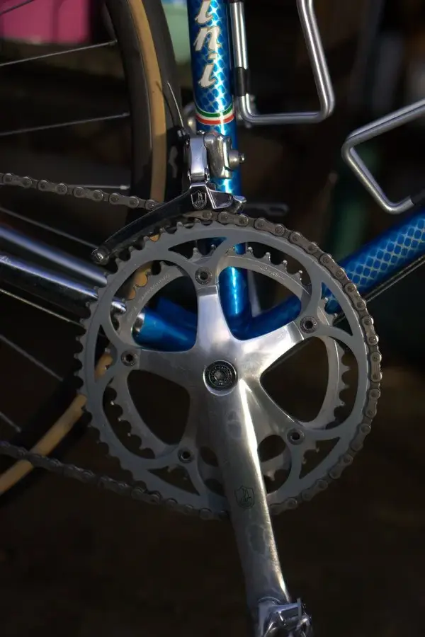

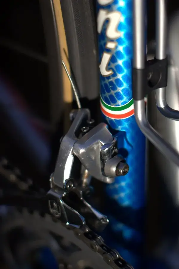

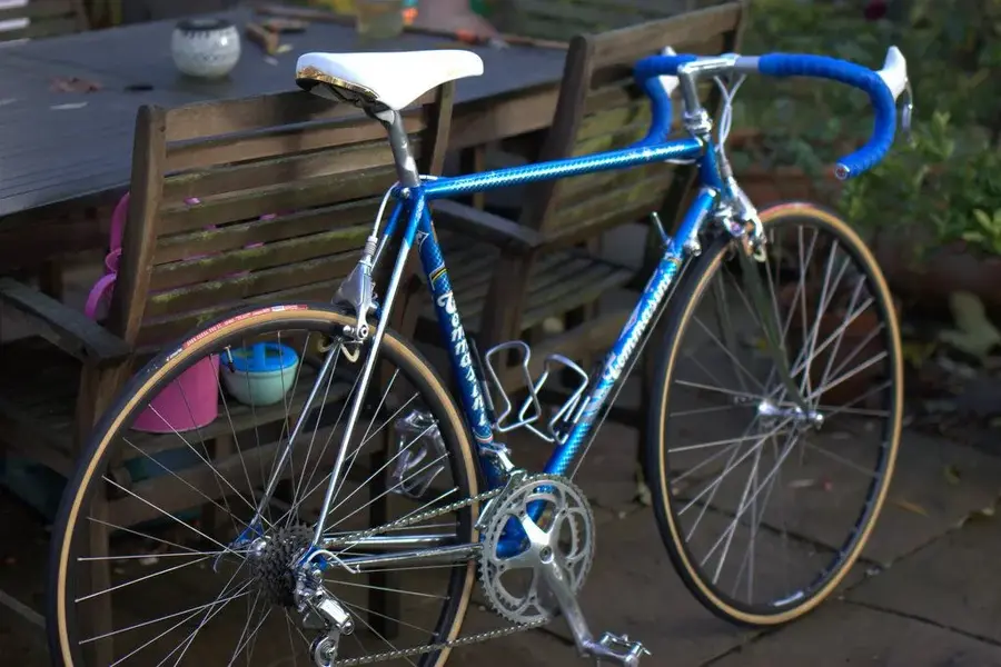

So the Tommasini is all but finished, just looking for some C Record leather toe straps and Tommasini bidons.
I've gone for complete Croce d'Aune with the options of C Record compact aero levers and friction shifters, some parts are nos others are used but in pretty good condition
Here's the full spec -
Frame: Tommasini Super Prestige ca 1990 in Columbus SLX 55 square
Fork: Tommasini Air
Headset: C Record
Stem: Tommasini pantographed Cinelli 1A
Handlebar: Giro d'Italia
Bar Tape: Cinelli Cork/Tommasini bar ends
Brake Levers/Brifters: C Record Power-Grade compact
Brake Calipers: Croce d'Aune Penta-Drive Delta
Brake Pads: NOS Campagnolo
Brake Cables: Jagwire
Shifters: C Record Friction
Front Derailleur: Croce d'Aune
Rear Derailleur: Croce d'Aune
Derailleur Cables: C Record
Cassette: Regina Syncro 92 14-28
Chain: Sedis
Cranks: Croce d'Aune
Chainrings: Croce d'Aune 52-42
Bottom Bracket: Chorus
Pedals: C Record 1st gen A601/602-AM
Toe Straps: Binda
Rims: Campagnolo Omega 19
Hubs: C Record
Hub Skewers: C Record
Nipples: DT
Spokes: DT
Tyres: Vittoria Open Corsa Evo SC - 23
Tubes: Vittoria
Saddle: San Marco Rolls
Seatpost: Croce d'Aune/Chorus Aero
Seatpost Binder: C Record
Weight: 10 kg

Re: Gavr goes Italian - Tommasini Super Prestige 1990 - comp
Very nice indeed Gav, great looking ride. Liking the component choice on this frame - a quality build all round. How many speeds you running?
cheers FINNEY1973. 7 speed this one, find I need some reasonable tension on the rear cable when in the small sprocket so that half the lever pull is not for the first shift. Then it just about pulls up into the 28 sprocket
Yep, am in the same boat - got the same mech & 8-speed shifters (supposedly) but not having a bit of of it - jumps, won't index, too many noises for it to be right. Have put that build to one side as it's doing my head in!
Anyway, lovely build indeed and just how did you get that camera effect?
sorry can't help with 8 speed syncro - a reputation for being a real pita. You could check the alignment of the mech hanger with one of these if you've not already had a go
http://www.wiggle.co.uk/cyclus-gear-han ... ment-tool/
Large aperture camera lens, Sigma f1.4 pretty much wide open
reputation quite rightly earned.

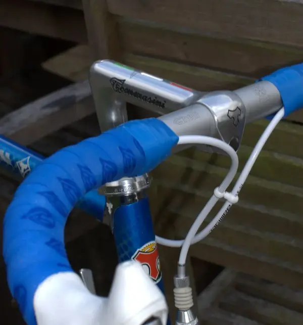

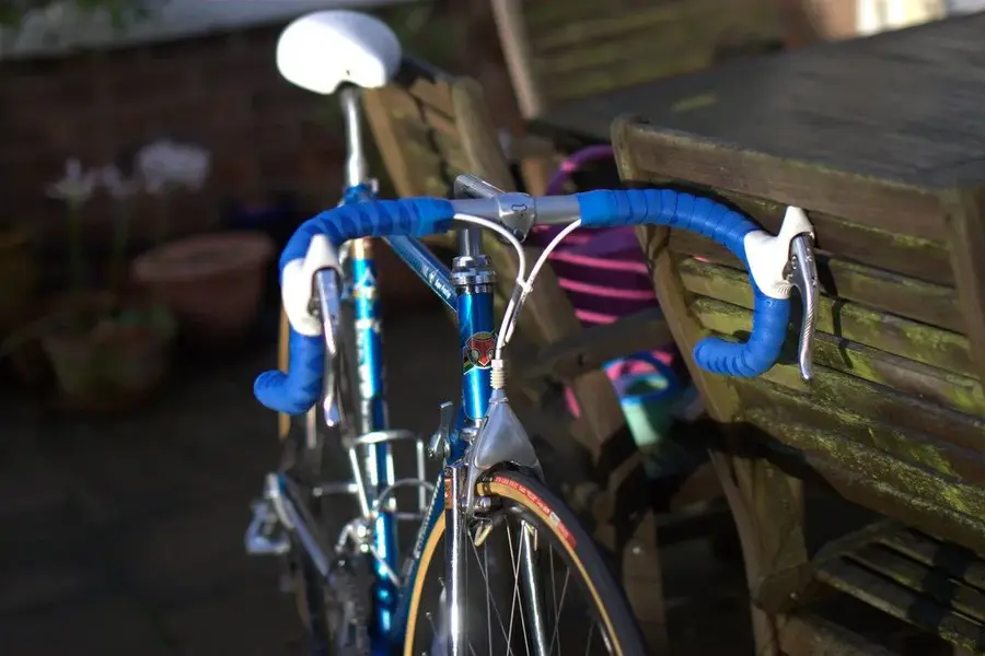

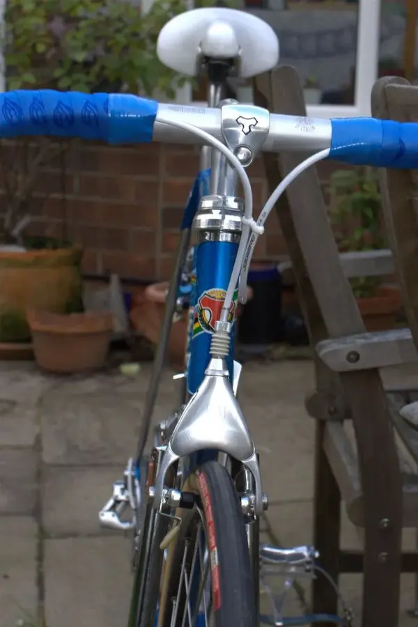

I haven't been able to find any good C Record leather toe straps so some blue Binda's will do the job just fine. Just some bidons to find now but I think that will probably have to be in the spring now. A few more pics to finish this off...
