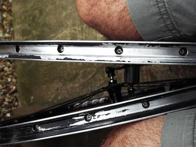

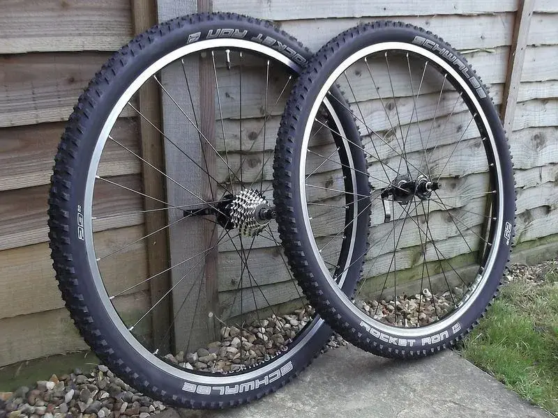

Firstly , the wheels . The paint was flaking off the inside of the rims which doesn't matter cosmetically , but didn't help with sticking the rim tapes down . So I cleaned them up with the drill and wire brush wheel thingy . Also , the edge of the rims were looking a bit ropey , with paint missing in a lot of places , so I also carefully took this off by hand with some sandpaper . Here's the result ,

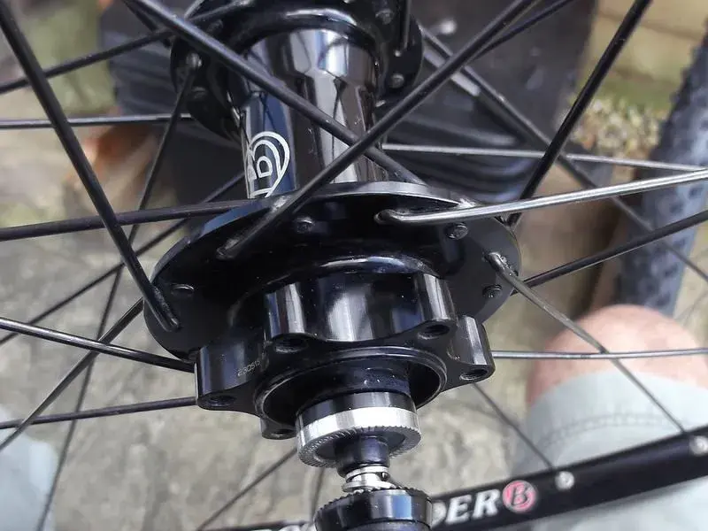

Wanted to take the axle out , just to check the condition/rustiness of the cartridge bearings . Couldn't work out how to get them out though , despite having the proper tool for the job :shock: :LOL:
, along with the normal cone spanner for the other side .Here's what either side loooks like ,

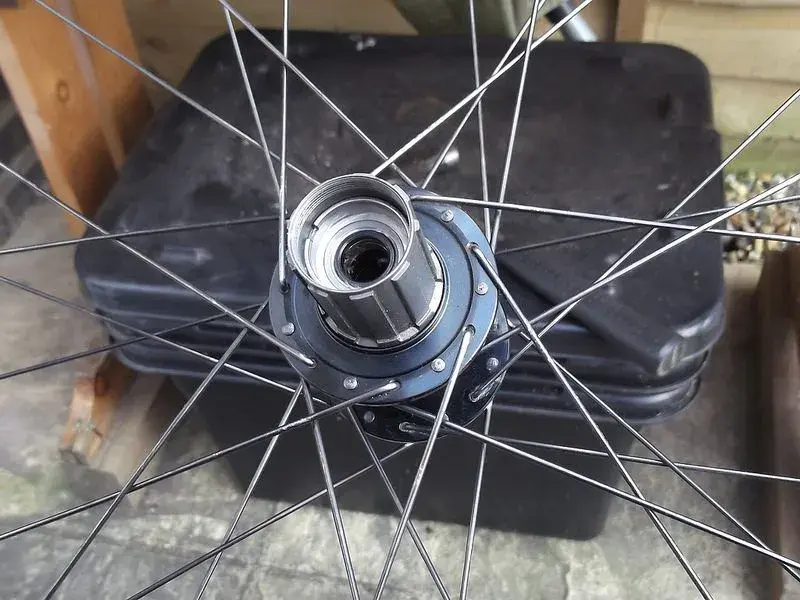

This was only the case for the front wheel . The rear wheel had a cone on either side ,so was easily removed . However :facepalm: having got the axle out , I couldn't work out how the freehub body comes off . It's held on normally by a 10mm allen bolt , but not with these wheels :roll:
Can anyone possibly shed any light ? Put tapes , tyres and tubes on , along with the 12-23 8-speed cassette :shock:
Only had a road one , so I'll see how I get on with that :roll: :facepalm: The chainrings are the normal 22-32-42 so shouldn't be too high for most of the local stuff .

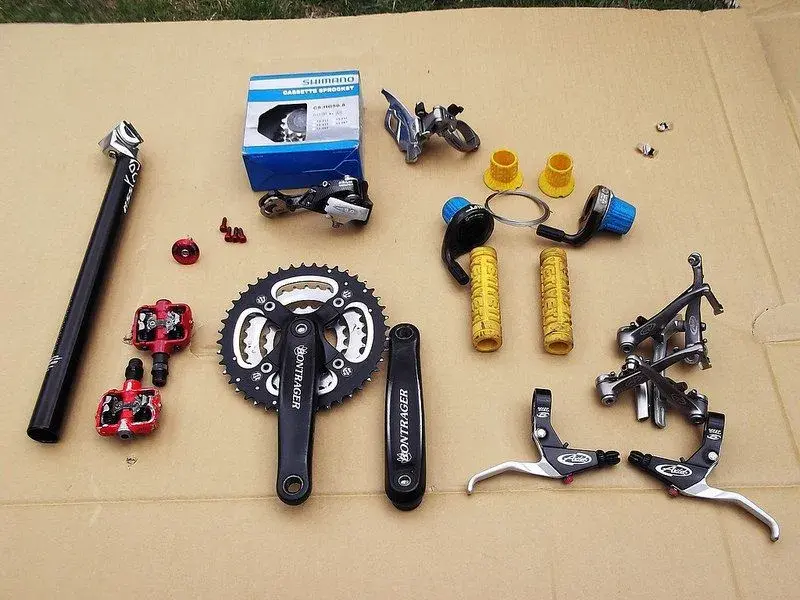

Here's the bits I'm planning on using for the build ,
Realised after taking the photo that I needed to clean those grips and paint the other pedal body , that had slipped my mind :roll: Both now done
Still need a b/b , chain and a saddle . Undecided on colour of saddle , but not black , there's enough of that already I think .

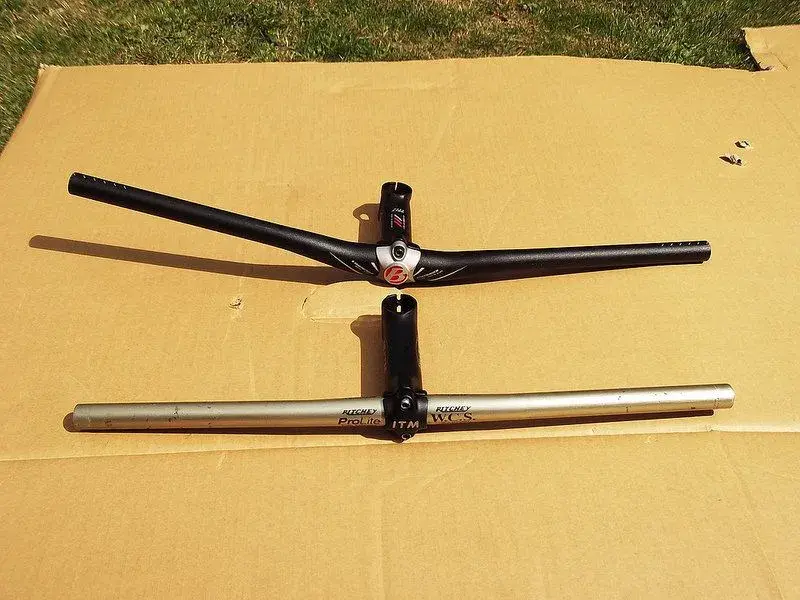

Got a choice of bar/stem combos . Would like flats , being an old race-head but the narrow ones would look a bit crap IMO , or wider , with a slight rise ones more conventional on a 29er .
Thoughts ?
I really don't want to get wider flat bars , but use some of what I already have .

Looking good.
Bonty stem, to match all the other bits, although, you may find you want a shorter stem, as seems to be 'on trend' with 29'ers. See how it rides.
I have fitted 585 wide bars to my new project, and they appear narrow by comparison to the 600 plus bars a lot of bikes have, I shall see how it rides.
As personal experience with my son's 29'er showed, you can go too wide and make the bike unwieldy, both when ridden and when trying to store.
Thanks for your thoughts Neil ,

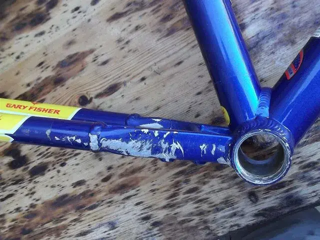

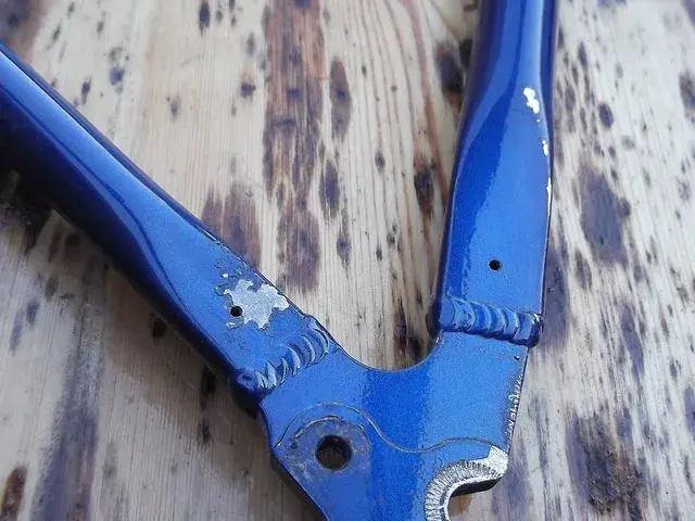

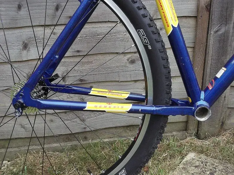

Now to start tarting the frame up . There was some paint missing here and there on the frame , and , to a lesser extent , the forks . The worst of which , was due to chainsuck ,
So after I heard about the nail varnish remedy on this forum , I went to Asda with my frame , and came away with candy apple red and ocean blue , thanks to Maybelline :LOL: :LOL: Got to work with them , and after a few coats , followed by a few more , and then some :roll: ended up with a happier looking frameset
Not brilliant I know , but I'm happy with the result , and it will be behind the chainset too , so not immediately obvious . The rest of the nail varnish touch up didn't look too bad either .

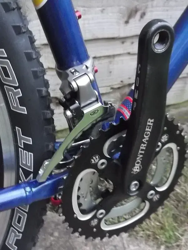

Next up was the chainset and mechs . Hit a stombling block with the front mech , in that it fouled the rear tyre . Being of the dual pull design , it was introduced to Mr Grinder-File , and was persuaded to become a top pull variety !
We have clearance !

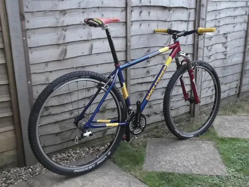

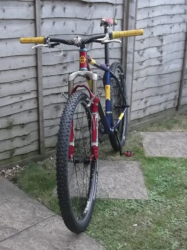

That's it for today , done the lions share of the build , having more time and progress than I imagined having . Got to order the chain when I've finished this :oops:
Still got to sort out the yellow paint , probably get some Humbrol enamel paint for that . Used some black model paint on the rims and they are looking a lot tidier than when I got them :cool:
As I only painted the other Ritchey pedal body yesterday , I thought I'd give it another day to harden before putting it back together ,
Not a bad job I think .

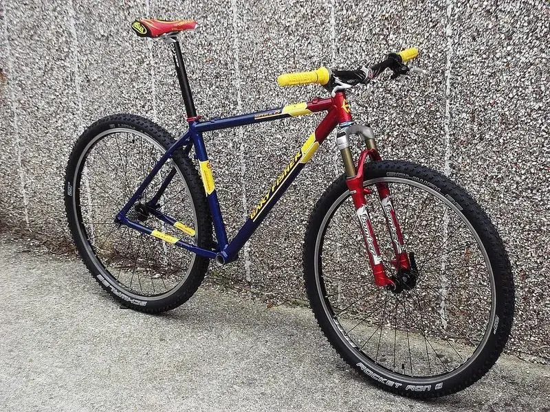

Re: Gary Fisher 29er . . . . . . from 2002 . Updated 24/8/14
nice job on the pedal cage, as well as the hole bike, Mike :cool:
that Bomber fork matching the paint of the front end perfectly. Nowadays you get used of the look of 29ers, but BITD the bike was kind of controvers discussion.
