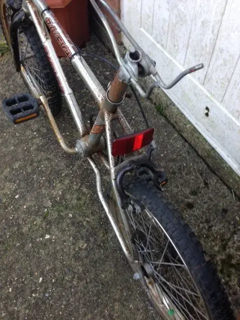

This quest was spawned on more after reading GITANE80's thread and his Burner restoration project. Anyway here are a few pictures as it arrived.
It looks pretty much standard apart from the grips. everything else is stock parts from BITD (albeit covered in rust)

Lovely bike you have there, you even have the r-nut on the seat post clamp and the rear chain tensioners. (The rear reflector doesn't look original to a mk1)..

I did think that about the reflector, it is branded 'Cat Eye' and not your more common round one. :?:
