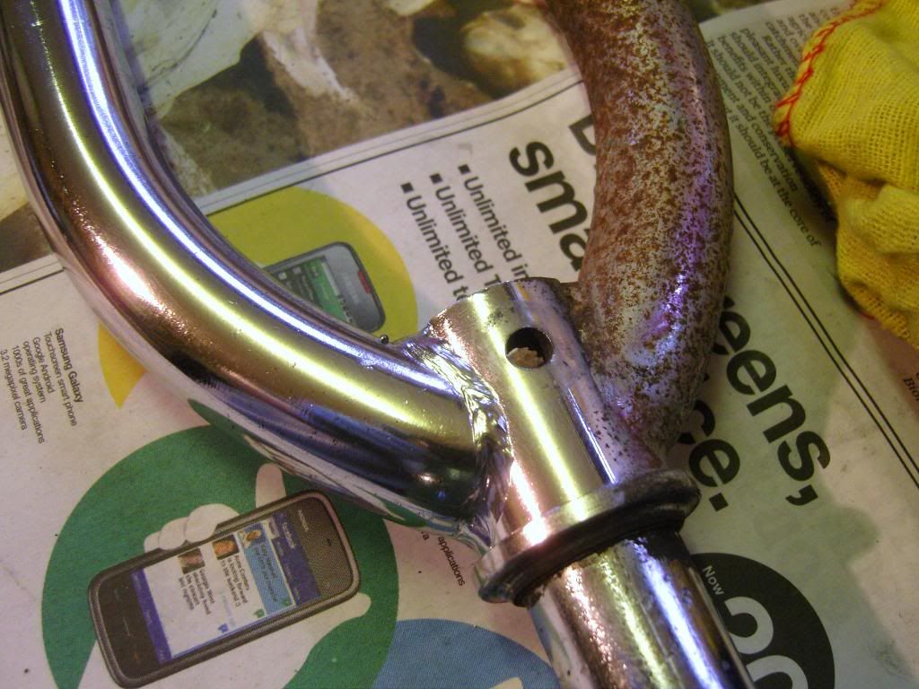

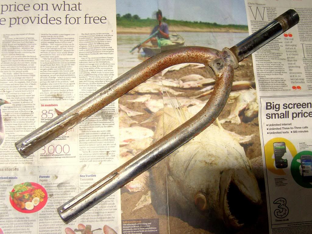

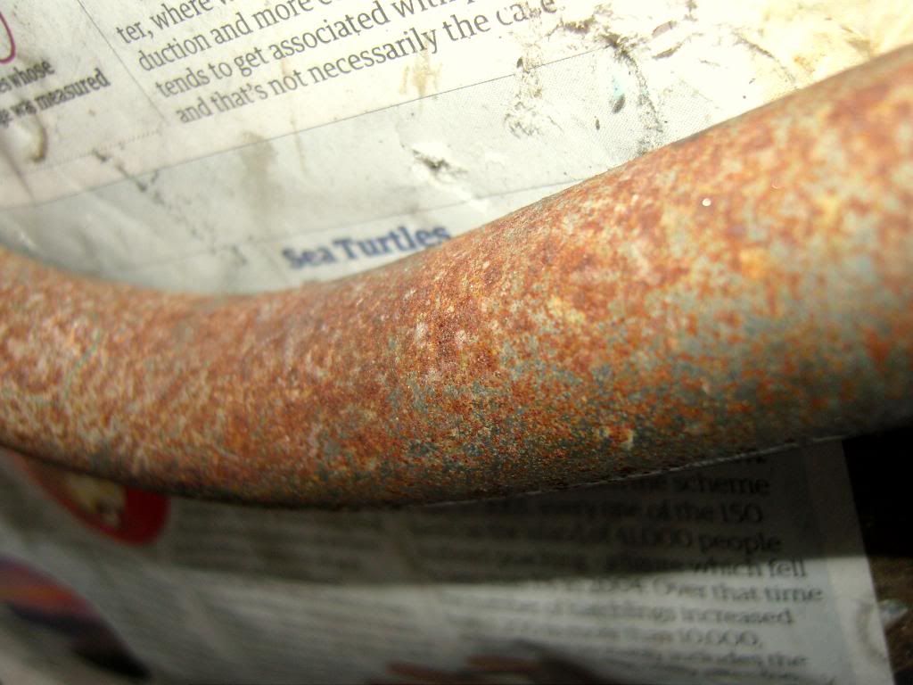

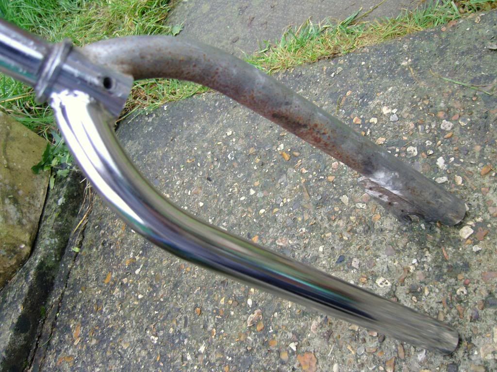

Right i have picked some forks here for this show

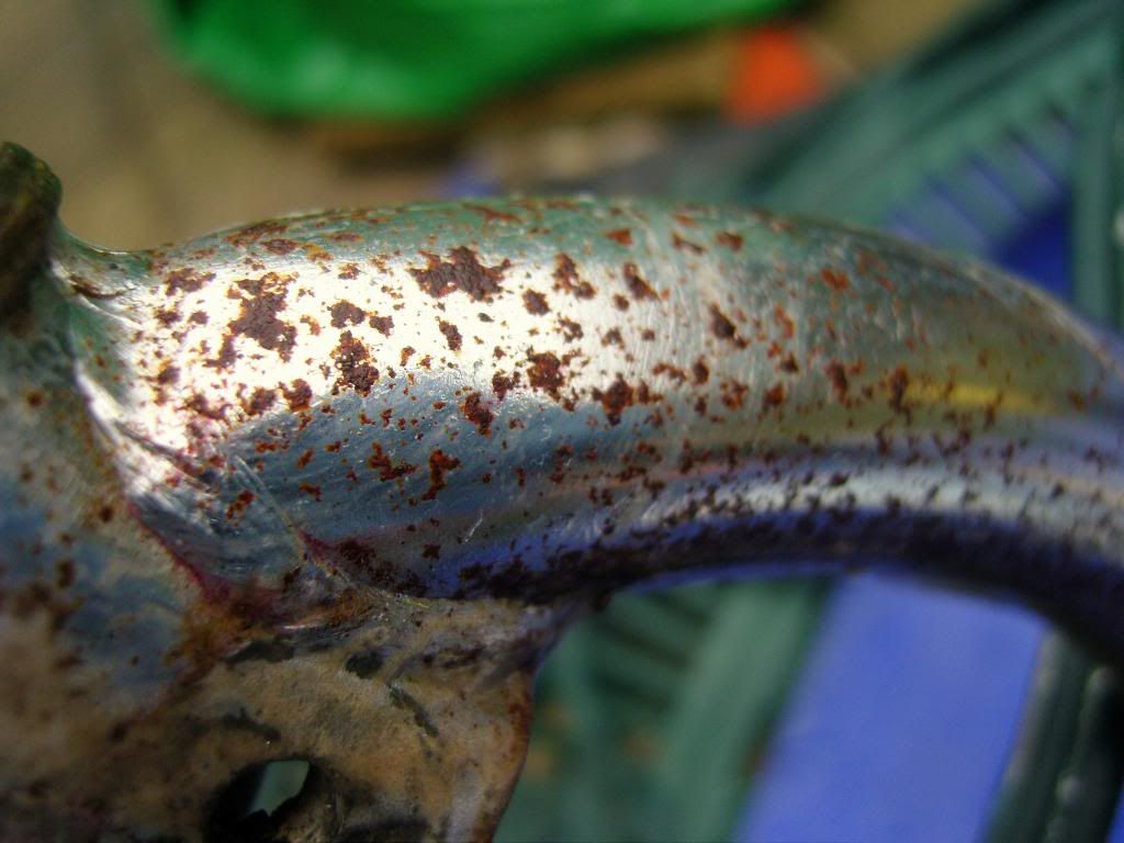

I had a look to see if there was any flaking of chrome and there was not - at this point you can't see if there are any lines in the chrome
Yes there is plenty of surface rust and i'm not sure if it goes deep
as you can see they look rough and most would just chuck them to the side

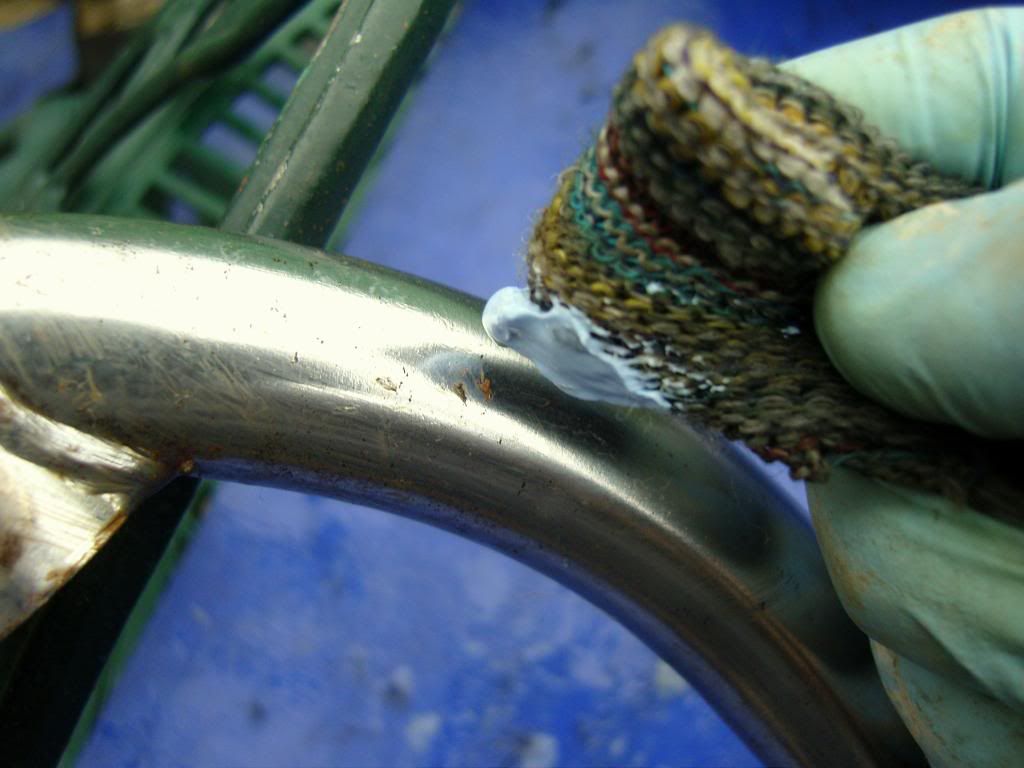

Now here is a great product - PEEK metal polish - way better than the more harsh auto sol which can do more damage i find - peek is a fine paste polish that you can use wet or dry - you can use it on a cloth - tooth brush - tooth pick - dremel mop

this will get a lot of grime off and show where the rust spots are

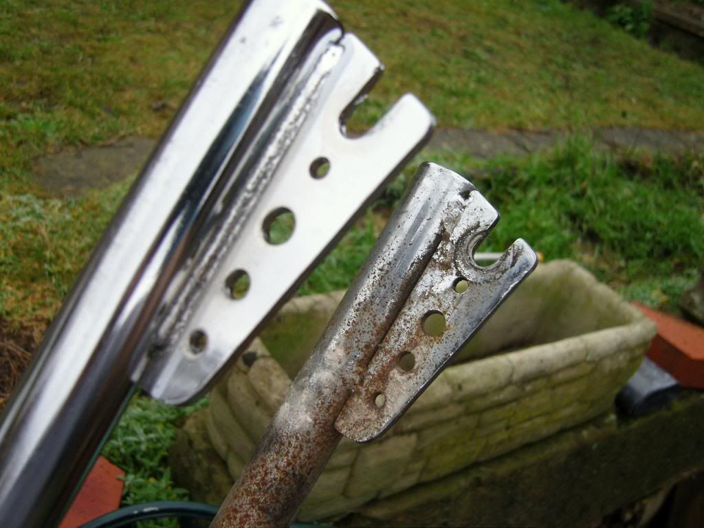

looks bad but know the time taking work starts - get a razor and wet the forks and you start to softly glide the razor over a rust spot - it will take the top rust off and leave a pin hole spot - do the whole forks but like a inch at a time - it you press to hard then it may lift up any bigger spot of flaking and muck it all up - softly will do the job and not leave lines any where
you have to work in the gaps and where the welds are - but the razor should get most of it up - it will take a bit of time but this bit is where it will make a difference

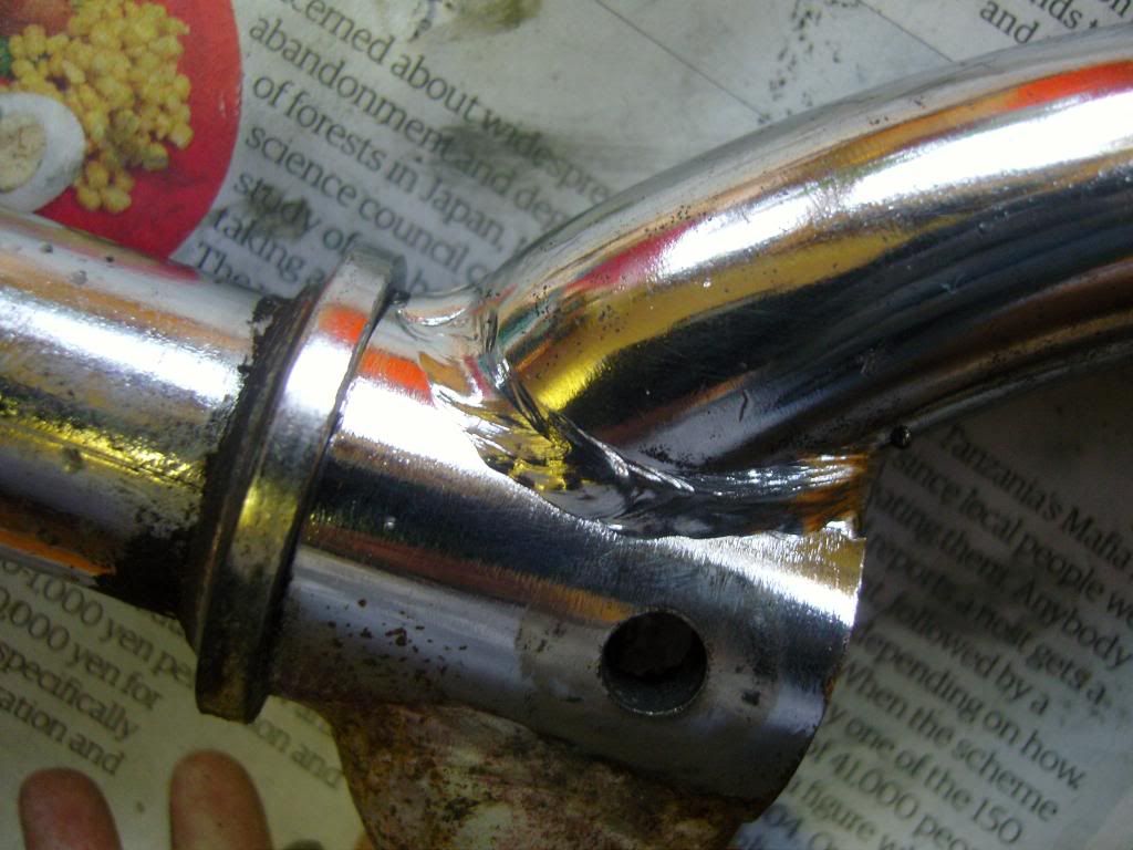

now that the razor bit is done it's a wipe off with a wet cloth and ready for PEEK

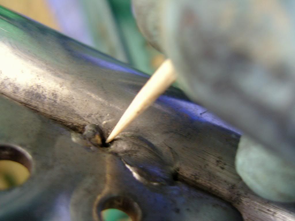

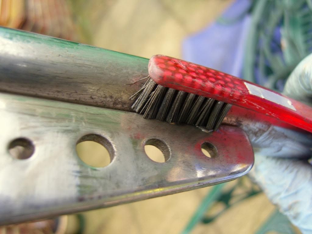

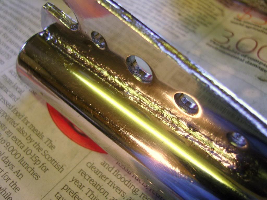

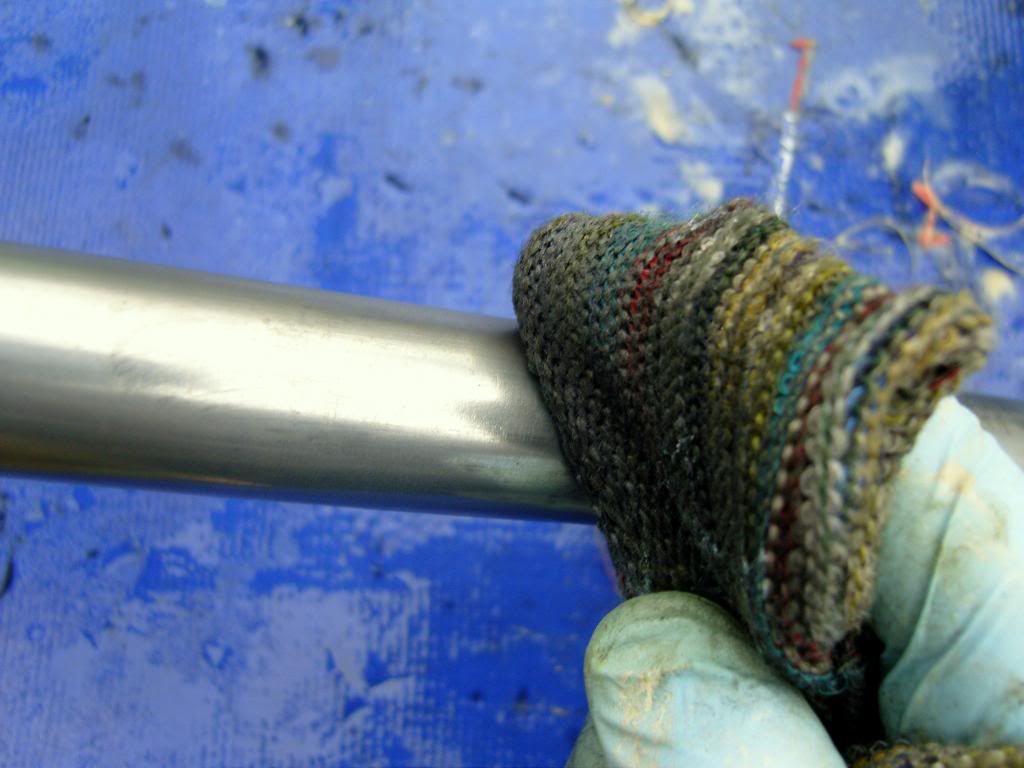

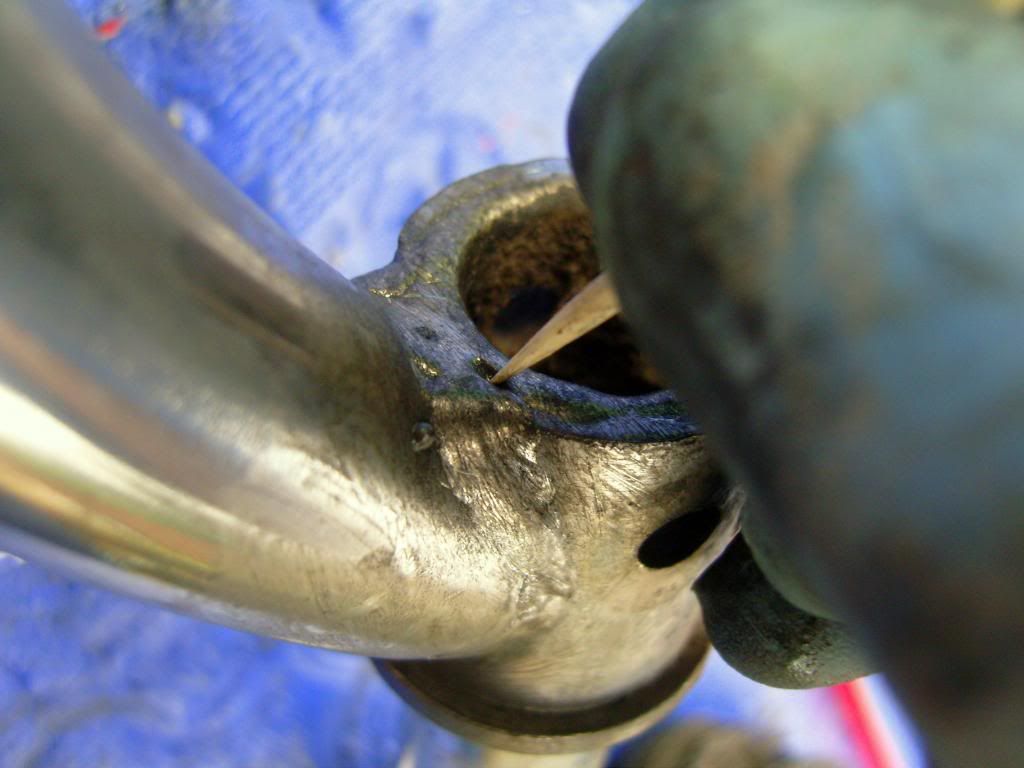

now you can see the dullness and some lines - get a cloth and put a couple of pea size dollops and start to rub in straight lines along the forks - it will wear you down and hurt you fingers, but no pain no gain they say - do the whole forks and the welds and any bits that are hard to reach use a tooth brush or a tooth pick (works well in the welds and weep holes )

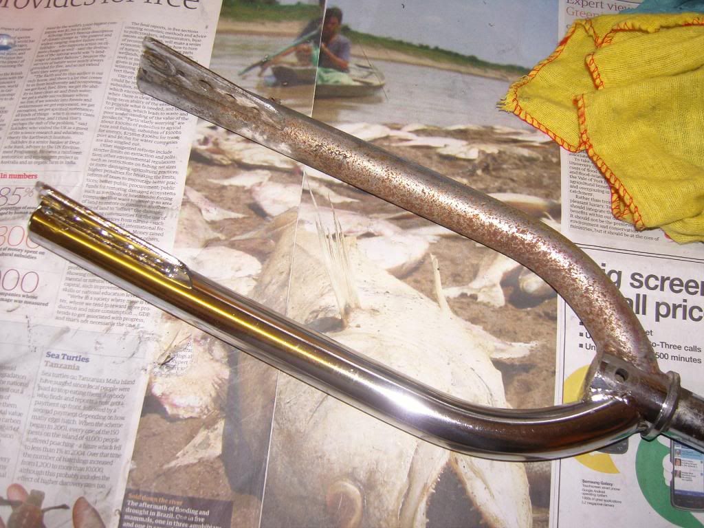

now that the peek has been used with a dry cloth, you can also get a wet cloth (a kitchen jay-cloth works well) and put some more peek on to it - rub in the cloth face and then work over the forks - this is like when you wet sand things - the water acts as a softener and a smooth finish will show - do this for a while as to flatten down the chrome and bring back the shine with taken of the dull lines and rust spots

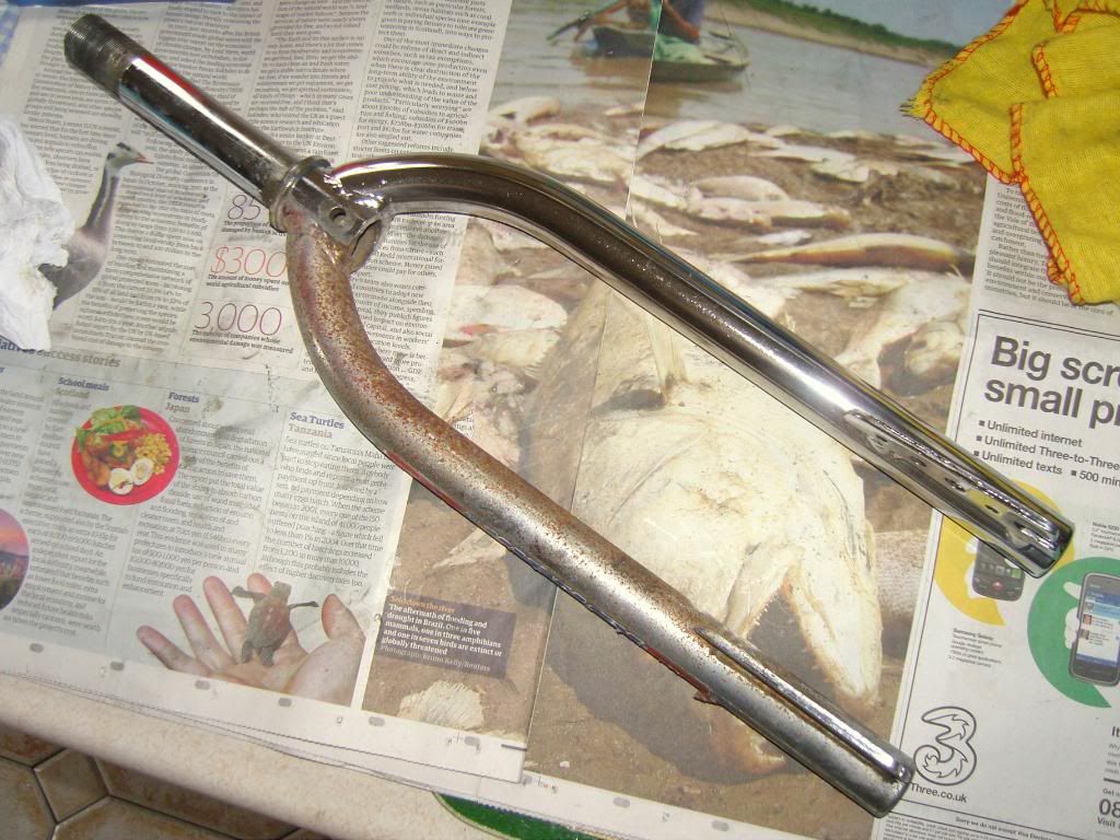

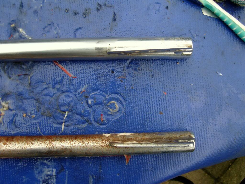

wash off any peek left and dry - you can leave it in the airing cupboard over night - once dry you will need to get the Goddard's cloth and start rubbing up and down the forks - a good idea is to have another cloth/duster in the other hand so not to leave any grease marks from your hands - work the cloth over the chrome for a while
once you are happy with the Goddards cloth then you can use a clean duster to shine it all up

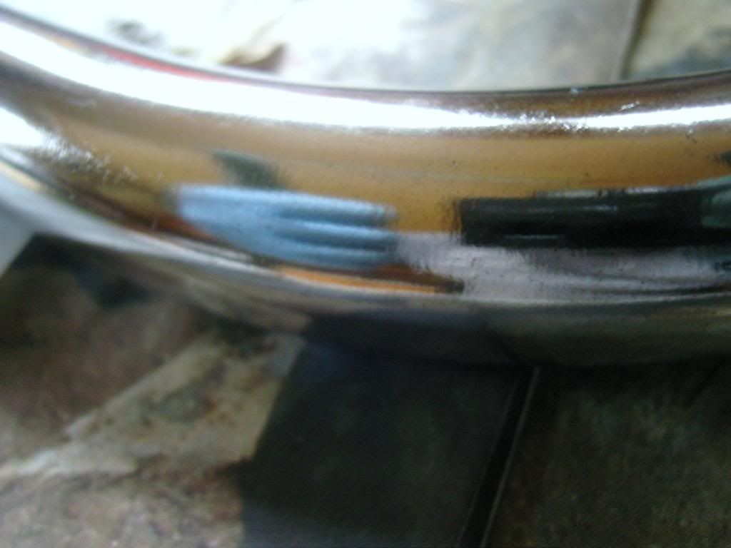

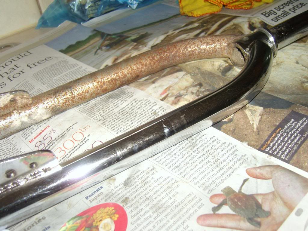

as you can see in different light it will show some of the rust spot pin holes and line - in different light it will hide them as the polishing with peek and the Goddard's cloth have help bring the shine back
So as you can see with a bit of know how and lots of hard work you can bring back most of the chrome - i'm not saying that it will work on all chrome and depending on how far the rust has taken - it is also up to your self to do the hard work - the more you put in the more you get out

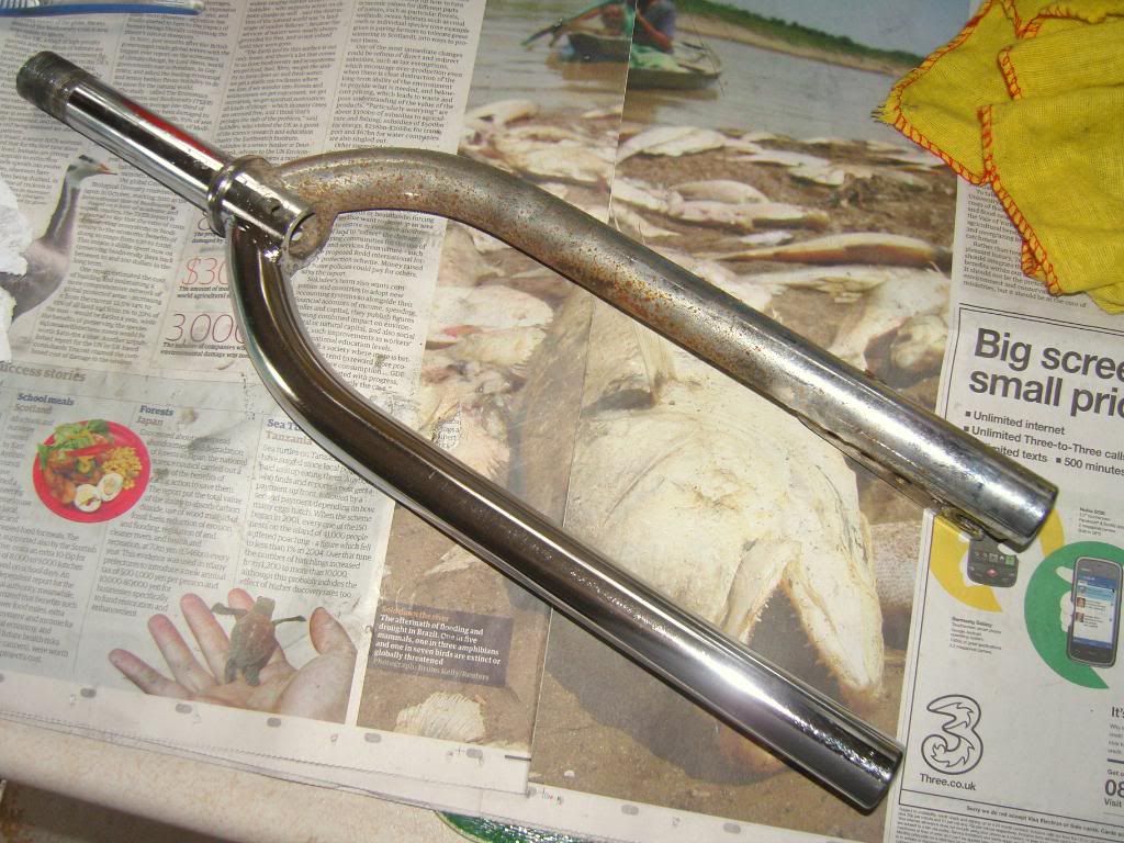

from this
to this
and as you can see i have not replaced the forks with a better set - this is how i got the mongoose cooked and brought it back to life - now go and have a try
