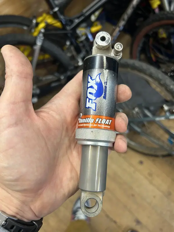

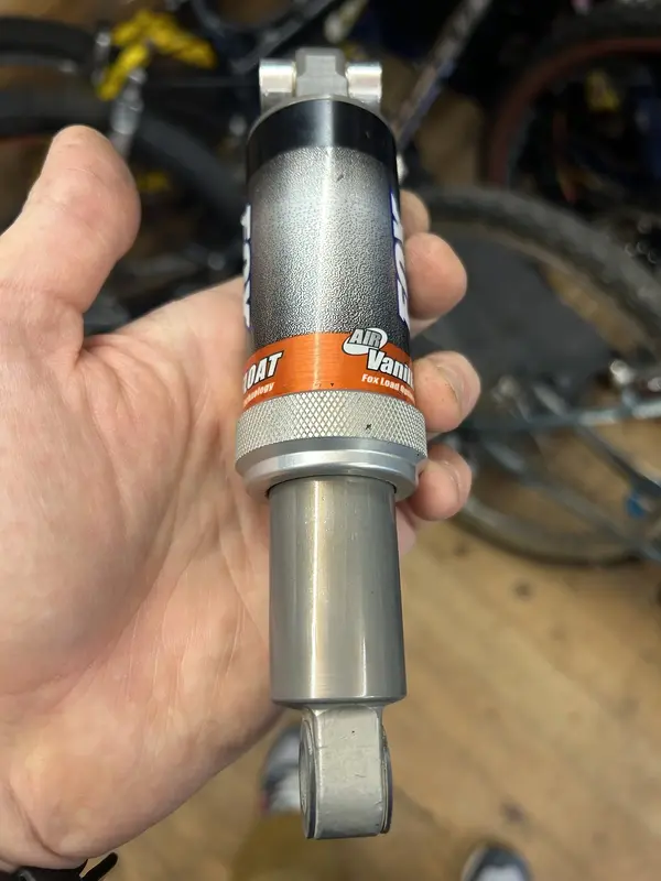

Got a Fox Vanilla Float in good working order I was keeping as a spare for my Turner XCE if interested?

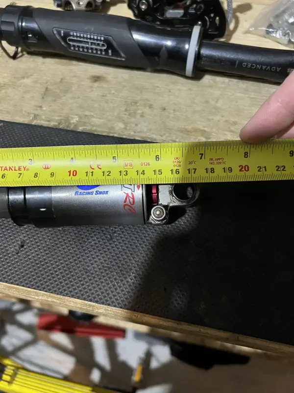

165mm c2c.
