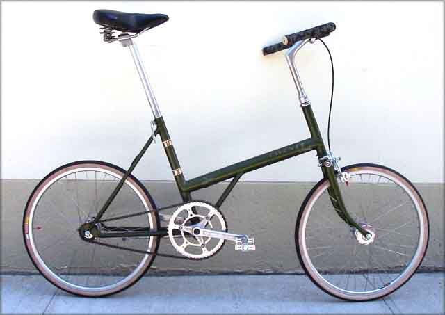

fixed gear qu...sorry

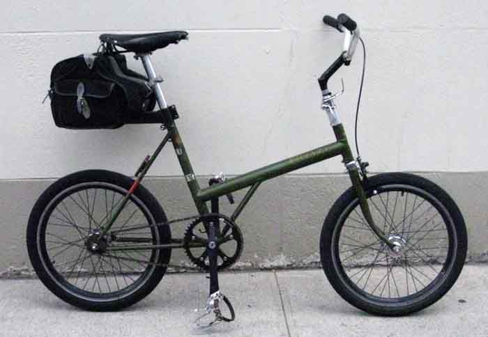

and here are 2 more that i like....
these are on www.bikecult.com
They often turn up on the fixed gear gallery .
For reference your steelies might be 20" 1 3/8 ; Or similar .
