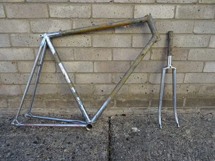

early 80's Velosport project
......so courtesy of a local alloy wheel refurbisher I have had the frame and forks dipped for the princely sum of £20.
As I suspected, the previous owner had sanded the chrome-work to provide a key for their rattle can respray which is unfortunate.
Anyway next stop is a yet to identified local spray shop for a single colour respray, it's an early 80's frameset so I'm thinking white-ish?. Thankfully the chrome on the panto'd seat stay caps is still in good order so there will be a nod to its original look.
Matt

My frameset does appear to have a chrome rear end but it looks as if the person who gave it the rattle can respray roughed it up for a good key (i'm guessing the forks are the same) 🤦
