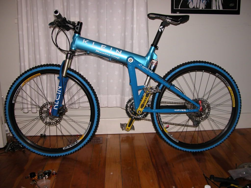

Do I have disc tabs?? 1999 Klein Attitude Comp with pics

I'd go for big.eck's caliper if i were you - i went to the trouble of tracking one down for my old Mantra and it just looked so right when I fitted it - set up very easy too - piece of business card either side of the rotor, squeeze the lever and bolt it down - done.
the rear stays like to break when using disks. be careful. it is for a good reason they stopped building them after one year..

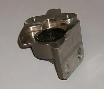

I have a 22 mm hayes side piece that I got from mechagouki about 2 years ago to use on my Trek Y-33. I never ended up using it and have now retired the frame so never will.
I believe you can use it to adapt a post-mount Hayes mag/nine/G2 caliper to the 22mm mount, and these brake sets are readily available online for not much (for example: http://www.cambriabike.com/shopexd.asp?id=85484).
I got it (see picture attached) for nothing + postage, and I am happy to pass it on for the same.
From the look of it it's never been used or built up, though it'll be well travelled having come from Canada and is now in Australia!
If you're interested PM me. (Airmail to the US would be about $10 Australian)

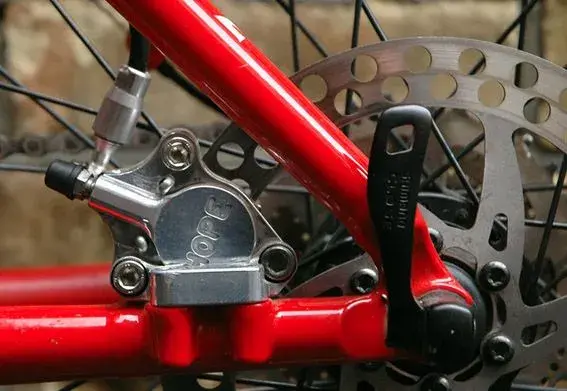

You could try sourcing a Hope C2 No.1 Caliper - I found one on here and with a bit of cleaning it came up really well and fits the bike perfect.
