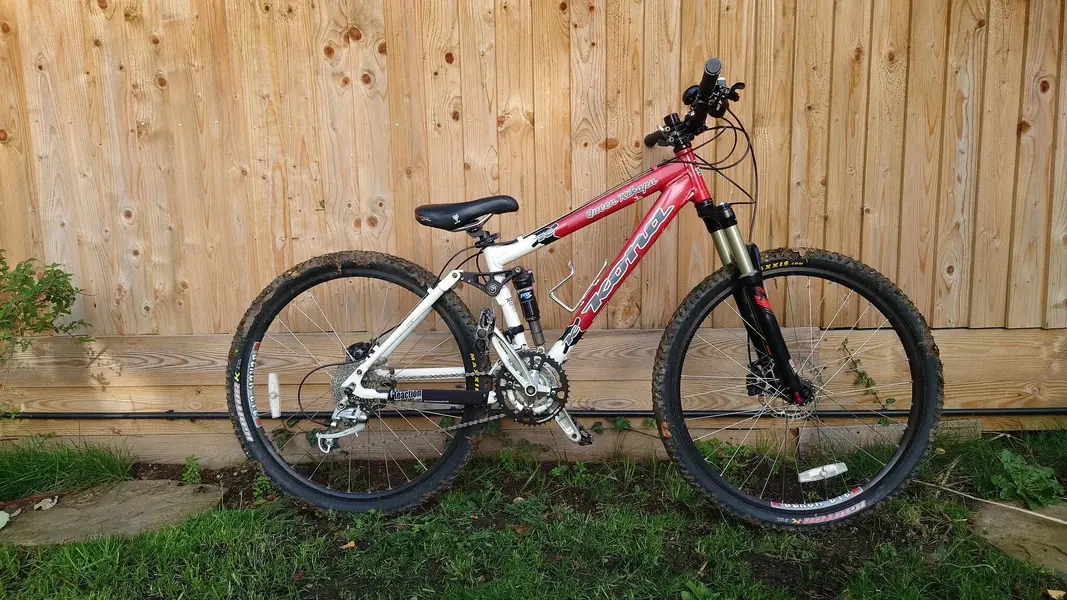

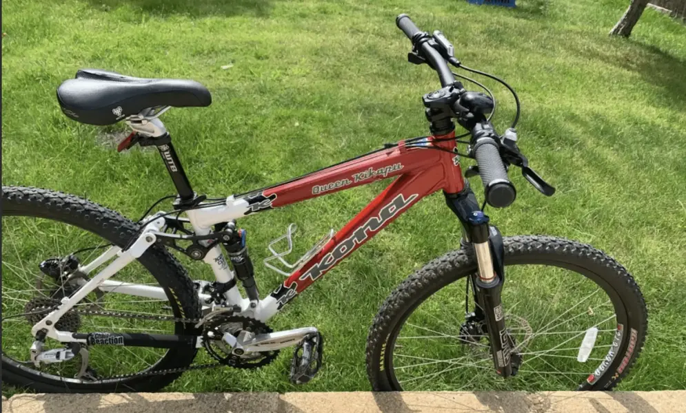

This is the most recent addition to the fleet, although it's actually for my 11 year old daughter.
I find kids bikes really annoying, you don't want to spend much money because they grow out of them too quickly but the cheap bikes are heavy and don't inspire confidence.
So I was on the look out for a decent 2nd hand extra small lady's mountain bike and this came up locally.
The listing said it was a 19" which it obviously isn't and it has a dent on the top tube. So I managed to bag it for £150 which is cheaper than a Halfords special.
The only issues with the bike was the lock out on the Rock Shox Tora forks wouldn't disengage, the back brake needed bleeding and the front hose was too short. I think the brakes were upgraded from Hayes to SLX which probably caused the brake issues.
I swapped out the forks for some Rock Shox Reba Race's that I had had in the shed. Put a new hose on the front and Bled the brakes. I also cut the bars down, put a different stem on on to suit my daughters shorter reach and I put a shorter seat post on so the saddle can be put lower. It seems to fit her quite well and she enjoys riding it.
Before
After
