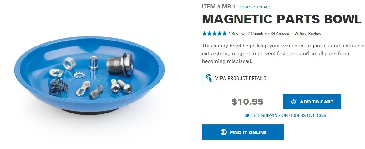

At xmas I treated myself to a couple of items from Park Tool, which are really useful.
Magnetic parts bowl - no longer do those small parts drop on the workshop floor, never to be seen again:

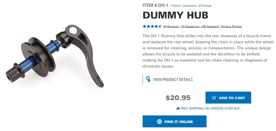

This thing - really useful for cleaning and lubing chains:
