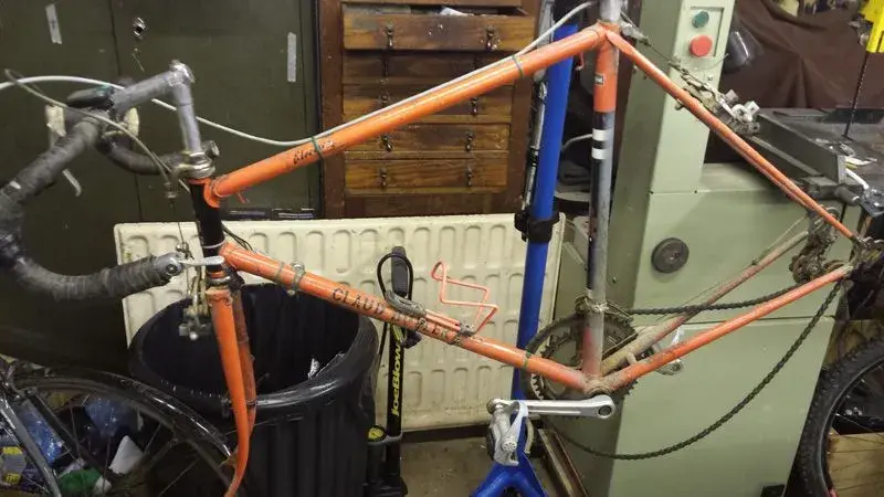

Good evening all,
I am new on this forum but have been looking through some nice pictures for a while now, and decided it was time to post. My late father had the aforementioned Claud Butler for many years, and I believe it was built from parts when he owned it. Due to his illness, it was not ridden for many years, to be honest I would guess no less than 15 years since it was last ridden. Due to this, it's in a rather sorry state and it needs some TLC. Being a younger rider (this may not be the reason), I tend to prefer the more racey carbon look of new bikes, and although I do see some retro bikes which I like, I would see 10 new bikes I prefer!
Rather than having it just sitting around, I am considering investing some time and effort into rebuilding it to a usable state. Unlike most, I am tending to veer away from it's orginal spec (or similar) and want to combine the old frame with a new groupset, perhaps some deep rims, to make this a stunning bike that I can ride.
If I am totally honest I am not sure quite where to start. Firstly I want to check that the frame is usable. There are some sections where the paint has chipped and I can see what I think is rust. Can this be rectified? I was thinking of getting the frame shot blasted and then powder coated (or should a retro frame be painted differently?).
Secondly, and as long as the first is a yes, then I wanted to talk numbers. I have had a few measures and the rear axle appears to be about 10 or 12mm smaller than the current standard for road bicycles. Treat me a complete idiot here, but I was hoping it would be a standard width. Does this mean I am somewhat limited in hub choice?
Thirdly, the current gear shifters are thumb shifters - one on the bar end and one on the downtube. The bicycle is 10 speed (2x5). Given the smaller axle, can a normal cassette be fitted?
I occasionally fettle with my bikes and would be confident stripping and rebuilding them. My problem here is the lack of knowledge - I have no idea even what type of bottom bracket would be on this frame. I would doubt it's a sealed unit? Probably packed bearings? But can a normal bottom bracket be fitted, is this a lot of work?
Lot's of questions, but I have lots of ambition for this project. I would appreciate any thoughts or help to my questions,
thanks very much

that looks a real treat , why not just give the frame a good clean and polish . And make the machine rideable and enjoy it for what it is .
shifters no reason why you couldnt fit sti's , or retro down tube shifters or a pr of bar end shifters all are poss , i should think a sealed bottom bracket will fit no aggro .
just enjoy what ever you do it looks great in my mind and eyes

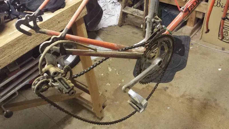

You can certainly put a 6 speed block on the back and possibly put a 7 speed one on, if you get the right one that is.
Your rear spacing will probably be 126mm and will require the correct size hub, although you could put a 130mm in it by springing the rear end apart a little. I wouldn't worry about cold setting it though.
It's a nice looking bike with Campagnolo Super Record stuff, which is top dollar and will last forever if you oil it a little now and then.

Eclectic mix of stuff there on that bike, early plate front mech (getting rare now), Nuovo record chainset with a later rear mech. Centre pull brakes and bar end shifters.
Do you have the wheels ?
It's worth more if you split it but if you want to keep it then the mechanicals are pretty agricultural.........I've been building them since I was 13
Paint doesn't actually look too bad :) Just looks like it needs a clean and change of the perishables.

If you found the original rear derailleur, it might have a 'pat' number on the top-bolt housing, which might help to date the bike. If you found the derailleur, you might find some old campag. pedals somewhere, too.
Campag. Record drive-chain with centre-pull brakes does suggest turn of the 70s or thereabouts. Rear spacing is probably 120mm- for 5-speed block, or single-speed.
Rant alert:
Please don't shot-blast, powder coat, or pull the chainstays out to modern spacing. If the bearings are OK, the only thing preventing that bike from being as fast as carbon is the rider, and with care it'll still be going, long after the carbon is landfill.
