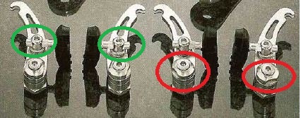

Incidentally another trick to alter cable pull is to clamp the cable the other side of the bolt, this alters the leverage a bit.
