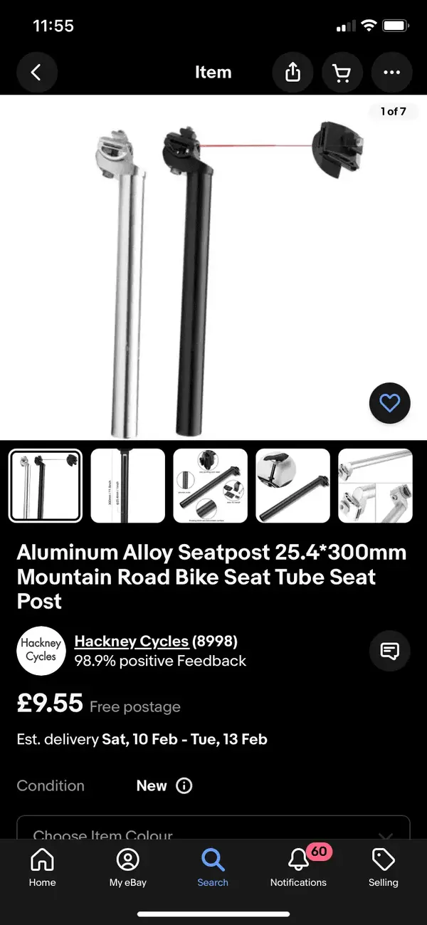

Yea, minimum you’ll get is 25mm Alan size and won’t get a shim that small. I’m surprised you’re struggling to find a 25.4. Does it have to be very long?
One here…
