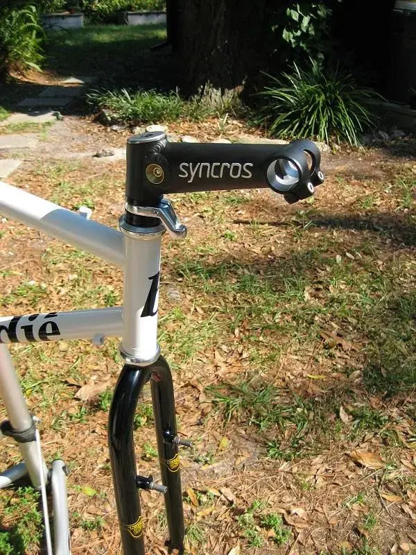

All it takes is patience. Modern spray paints are capable of remarkable things. This frame looked like hell when I got it and now I have a paint job that folks would never guess was a backyard job. If you want to paint a bike yourself, just take your time and do it right and you'll be amazed what you can do. :D
Now...more importantly... Anyone know if a Catalyst takes a 26.8 or a 27.0 post? :LOL: :LOL:

Wheel building marathon benefits were also bestowed on the Brodie. Mavic 222 slate blue rims with Deore DX hubs, converted to run 8 speed. I also swapped out the Syncros stem for the RM stem shown here. That Syncros is so large I can only use it on the white EWR. Too bad too, I thought I'd found a home for it with this frame. :oops:

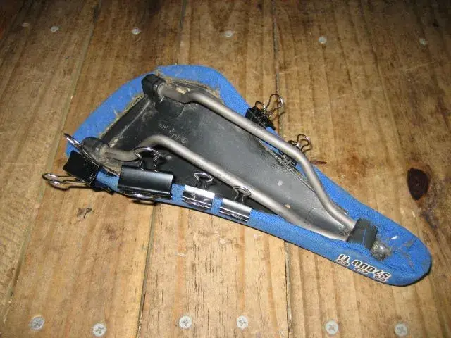

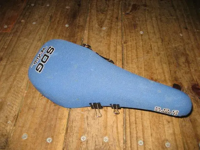

Had to glue up an SDG for this build also. I want to ride this in the dirt, and that meant a used SDG and not a new SDG. A little Contact Cement and we're sorted! I must lower the tail of that saddle before I ride.
