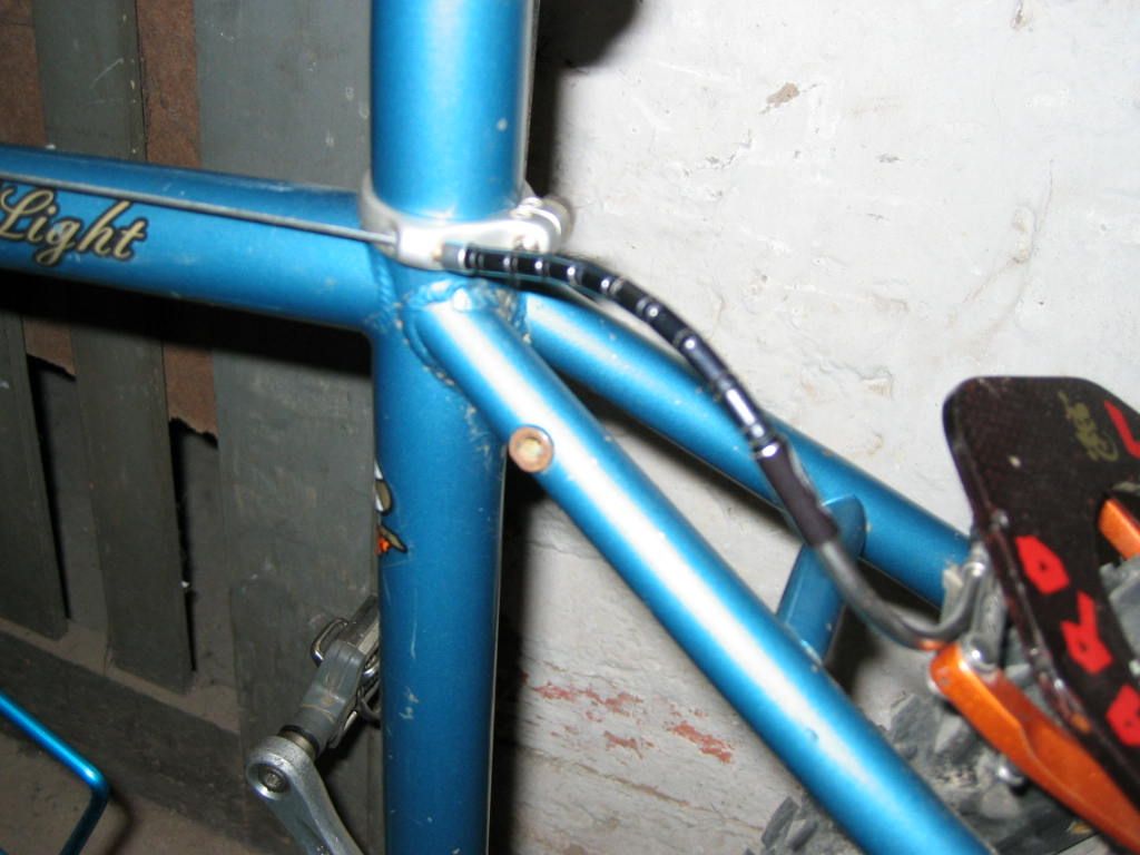

oh and for the OP this is a user called garethRL's solution to your problem using nokon housing
i probably have a wee bit of nokon somewhere you can have for some karma if i can find it
