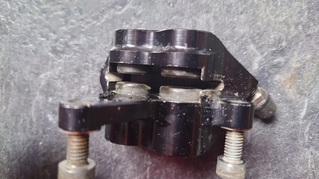

This one was cheap on eBay as spares or repair due to chipped pistons. It looks to be in very good condition and the threads are good, next step is to strip it down
The good thing is the inner pistons are sitting proud so I can get them out relatively easily. You can just about see some the chips on the pistons.

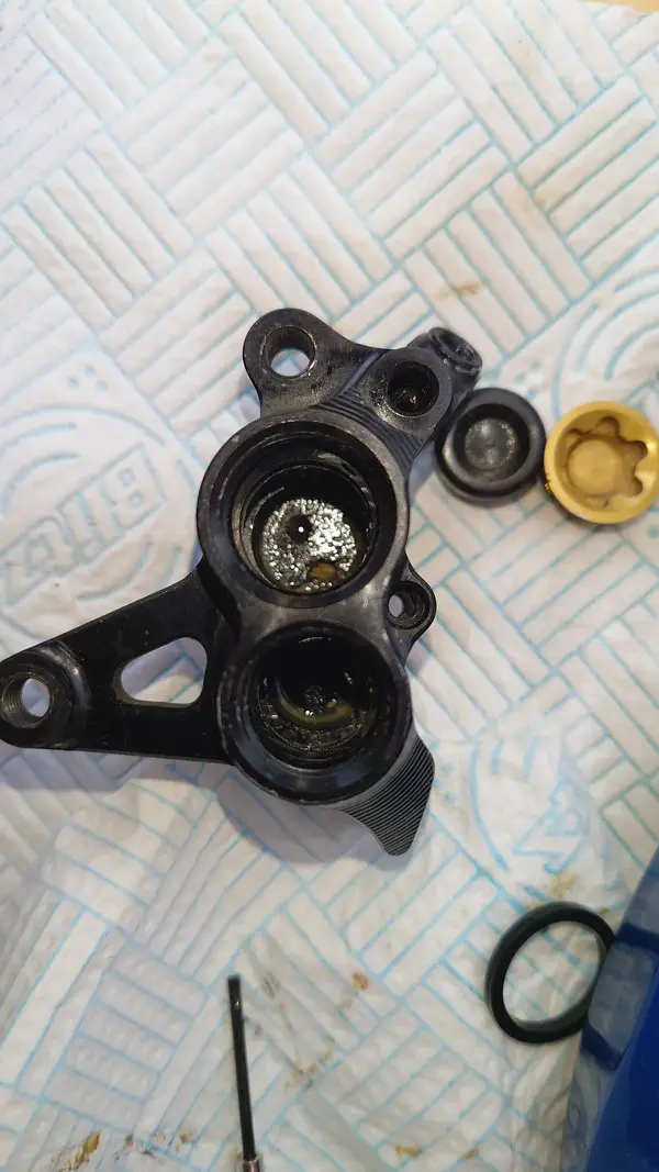

Bore caps off and greeted with all this gunk.

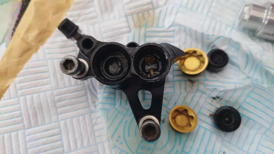

Get all the pistons out and find more gunk in the bottom. I have no idea what it is.
With the seals removed and the caliper dry I can see that some of the gunk is really hard, and in the threads of the large bore it looks like there's the remains of some sealant. That might explain the gunk, so this caliper must've been stripped before. Behind the seals is also some of the dried gunk which I've managed to clean out. So it's all stripped down and pretty clean.
I'll wait for some new seals to turn up before I strip down the other caliper and decide whether the other pistons are OK to reuse.
Just that bit of cleaning and it all looks so much better.

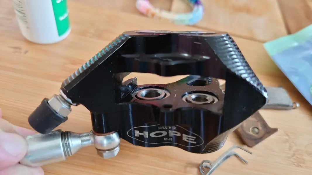

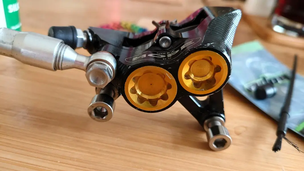

Rebuild complete, a few years ago I'd be scared to do this job but it's actually very simple. I like that hope still support some of their old products. The pistons of the damaged caliper were in very good condition so I reused them. Had some ti bolts off an old cross country bike so they'll help tart it up a bit. Now all I need is a downhill frame to put them on.
Came out looking real good!
