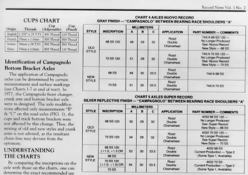

HI Have you double checked axle size, is it old style or newer theres a difference of 1.5mm on a double.
This might help.
The bottom bracket is a Campag Nouvo Record Triple - specially made just for triple chainsets with a longer offset on the drive side.
I'm beginning to think its not worth the effort - even though I would really like it on the Holdsworth!
I have a Daniel Salmon which has a large indent on the chainstay specifically for a triple - so may fit it to that.
