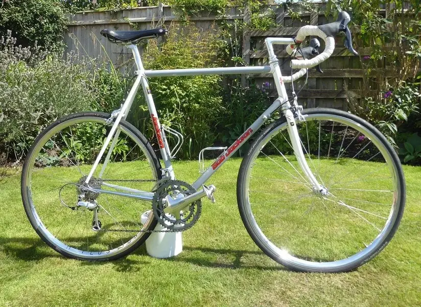

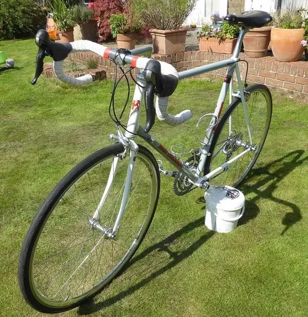

Here’s the build-up:
This bike is used for all kinds of riding, including putting a rack on for lightweight touring, so has gearing suitable for the steepest of hills, now with a 26 inner. This generally gets me up anything Yorkshire can throw at me, including Park Rash and Rosedale Chimney, but nothing is guaranteed. Mixture of modern spec with one bit of bling, a Dura Ace seat post.
By the way, Peachy, your account of building up the bikes with your son one of the more heart-warming contributions on the forum, keep up the good work!
Frame: Reynolds 731os 1995
Fork: Reynolds (as 731, 708 and 653) 1995
Headset: Stronglight A9
Stem: Cinelli
Handlebar: Randonneur
Bar Tape: 3T, white with red stitching
Brake levers / shifters Ultegra
Brake Calipers: Ultegra
Brake Pads: Swiss Stop
Brake Cables: Shimano
Front Derailleur: Ultegra Triple
Rear Derailleur: Ultegra
Derailleur Cables: Shimano
Cassette: Ultegra 10 speed 12 - 30
Chain: Ultegra
Cranks: Ultegra
Chainrings: Ultegra 50 / 39 / 26 (Stronglight)
Bottom Bracket: Dura ace
Pedals: Shimano A600
Rims: H + Son Archetype
Hubs: Novatec
Hub Skewers: Ultegra (Supplied skewers didn’t hold on chrome)
Spokes: Sapim
Tyres: Continental GP4000 25mm
Saddle: Brooks Swift Titanium
Seatpost: Dura ace
Bottle Cages: Cannondale GT- 40
Weight: 9.3 kg / 20.5 lbs
