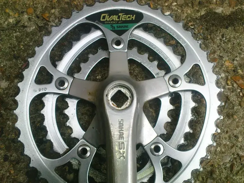

BioPace/Ovaltech problem - need your help
Dr S":23i7bfu6 said:
Can you fit biopace rings on a singlespeed without a tensioner??
Strangly, yes! Chris makes them for BMXs and track/fixed bikes but says:
Yes, and you won't need a chain-tensioner if the ovality is less than about 15%. But, to be safe, don't exceed 10% with fixed-gears.
Most Biopace are very lightly oval, 10% or less, so you should be good.
smartarse":23i7bfu6 said:
How do you rotate a 5 arm chainring through 90 degree's ?
I know, I know....
You may need a tensioner to use this one though:
I have got a Durham oval somewhere like this one (although not as big) and it's evil, very oval and very sharp and pointy!
Aha - thanks.
The outer ring on my setup isn't oval'ed, or sakae stamped. The middle one only says 38, and the inner one has loads of writing on. The outer ring is the only one with a tab...
This gets stranger by the minute - i'll assemble it all as per the photo, shouldnt go too far wrong
Thanks for your help...
