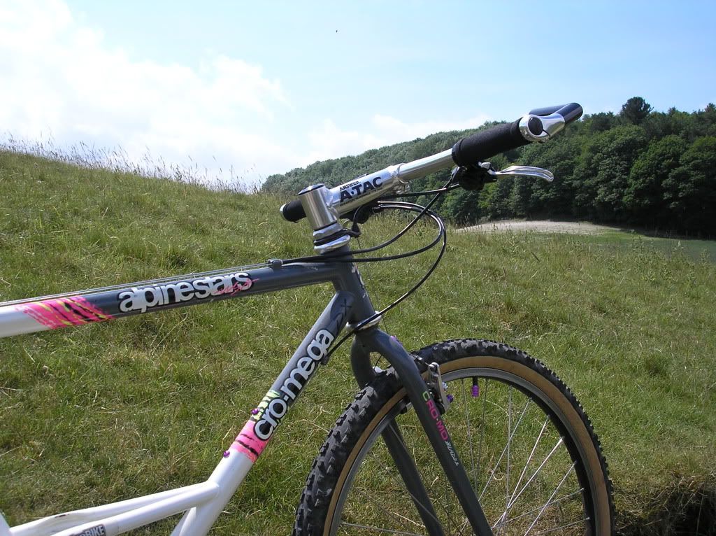

Atac is my fave
Closely followed by Controltech
