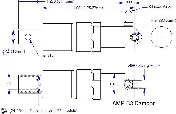

Fascinating reading. Thanks guys. Interested cos I have what I believe is a b3 with oval downtube with a pair of f3 forks. Unfortunately the rear shock is a tad lacking, what options are there for rebuilding or replacing?
Hi ZTH,
I've not seen a specific parts list for the shock, but the AMP shock is a pretty basic coil over oil shock.
Details in the middle of the AMP 1997 service manual, here: https://www.dropbox.com/s/cm4utlrpjveys ... l.pdf?dl=0
Best option really is a new Risse Genesis air shock :D $198 + shipping.
Specific shocks for the two B3 specs, B4s and the B5 still available.
Here's the two B3 versions. The difference is in the diameter of the shaft clamping shaft (wheel end, left):
Specific webpage: https://www.risseracing.com/amp.shtml
Kevin Risse (sales@risseracing.com) still services old ones if you find one (and a whole load of other old shocks etc). https://www.risseracing.com/airshocks.shtml
Although AMP themselves don't offer product service anymore (They did stop making them 17 years ago, now :shock: ), there are some useful manual/brochure/info downloads here: http://www.amp-research.com/company/his ... ain-bikes/
All the best,

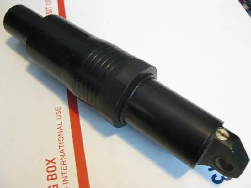

Came across some AMP stuff recently. Can't quite figure out what's going on with this rear shock. No valve sticking out, it it just sheared off and broken?

Without the back story to these pics you dont really know what it went through to get it to fail. Certainly that one is a big rear landing, so is it a case of the owner over estimating its strenght ?
