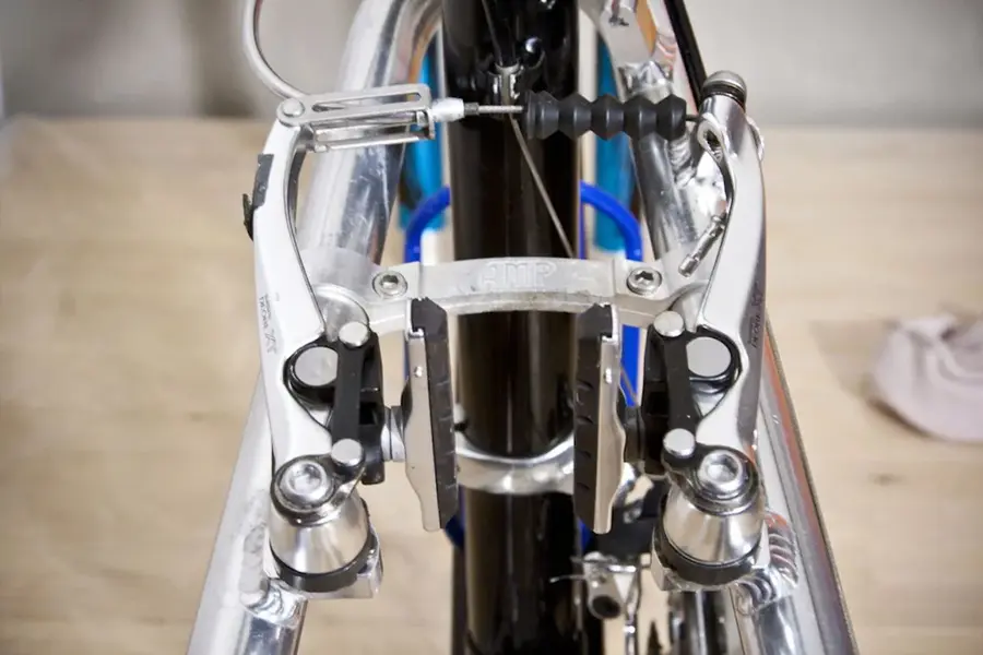

It's a beefier version of the amp brace that bolts the two seat stays together to create a bit more rigidity at the rear end. Think of it like a brake booster for a frame. It will also have a similar effect on braking as a brake booster.
Got it.
Was the AMP version not fitted as standard? There seems to be quite a few bikes without them which makes me think they weren't, plus there's an aftermarket version.

Possibly an optional extra. I think it was called an afterburner brace or something along those lines. I think the twp version could come with an integrated canti hanger making brake set up slightly more central than the frame mounted amp cable stop.
They were standard fitment to B3's the TWP one was an upgrade fo B2's
